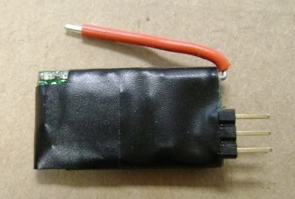

Originally Posted by Simon View Post
Apply tape onto the Empire RF transmitter as pictured. Try to leave the two LEDs uncovered, so you can check that its receiving a signal once connected.

you need version 1.20 for that setup to work on 09's
