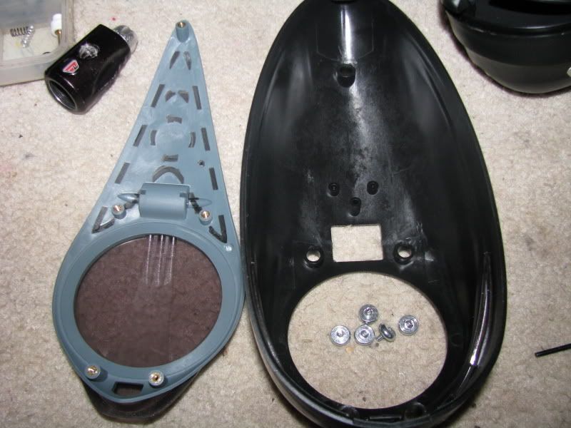

How To Mod A Crown On Your Rotor With No Permanent Effects(no Glue)
figured out a slightly ugly way to attach a crown to your rotor without permanently modding either piece.
*note* margin rape is imminent. will fix later.

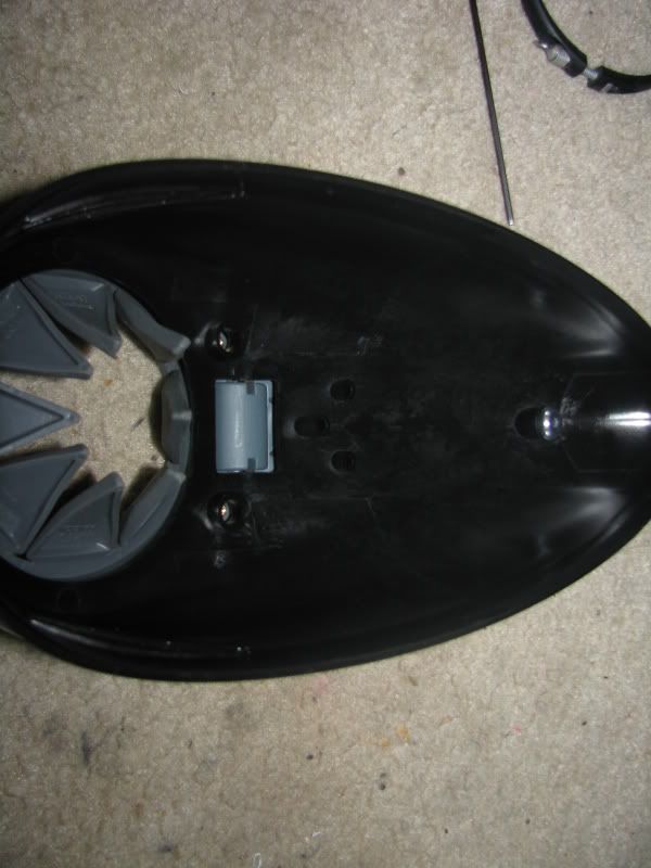

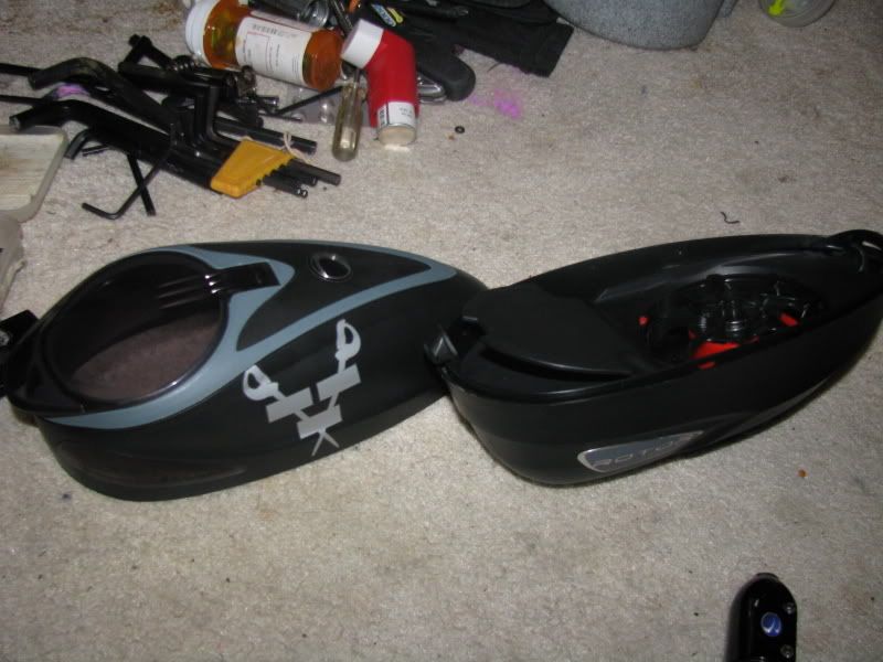

step 1
remove top half of rotor by pulling up rear tab, then pushing in rear button whilst pulling on top half.
step 2

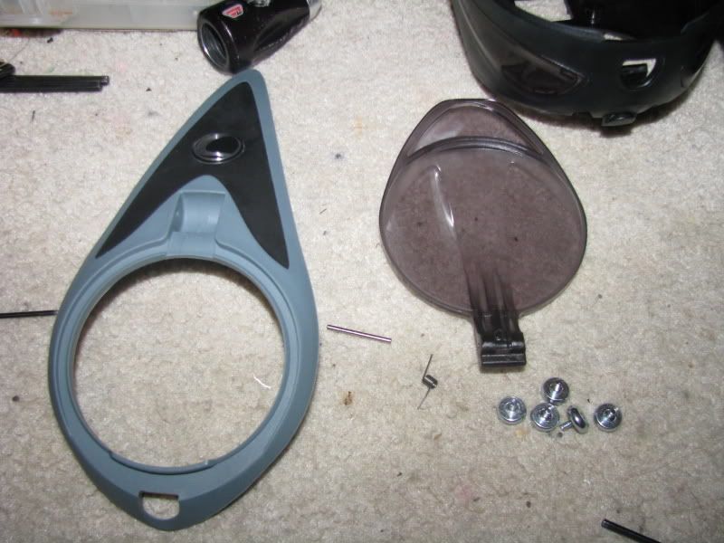

remove colored part by removing 5 screws
step 3
remove lid by pushing pin through partially with allen key, then opening lid, pulling one corner out, and pulling it off of the pin.
step 4

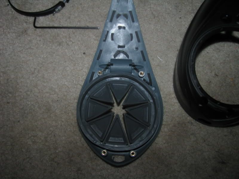

position crown in colored section as such, aligned as such
step 5

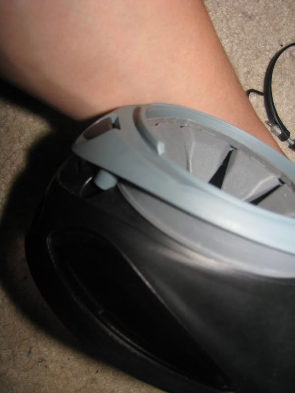

pull tab all the way up in back of bottom half
step 6
latch the tab holder onto the tab of the bottom half, and position crown such that it looks like the finished pic at teh end
step 7
force front of colored part down, and screw in front most screw.
step 8
almost done. this is what your crown should look like. centered as possible, with minimal of the non tab section showing all around

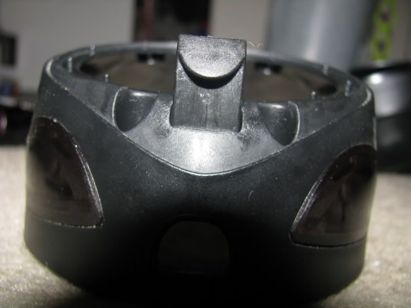

step 9
put a pod in backwards to reform the crown to the new shape for 20-30 mins at least. be careful when pushing in and try wetting the pod or wiggling it in.
step 10
DONE.
this is what your crown should look like after the pod bit
and this is it after a case dropped through it.
NOTE* this mod does not allow you to use the locking tab to attach the top half of your rotor securely to the bottom half. it will still stay on perfectly fine as long as you arent pushing the release button between games or anything.
i am not responsible for any damage you may do to any parts involved in this mod.
have fun.
