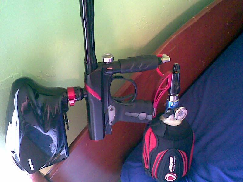

pic of my hero frame incase you wanted to see:
that was a prototype lucky frame with a s4 board build into it.
