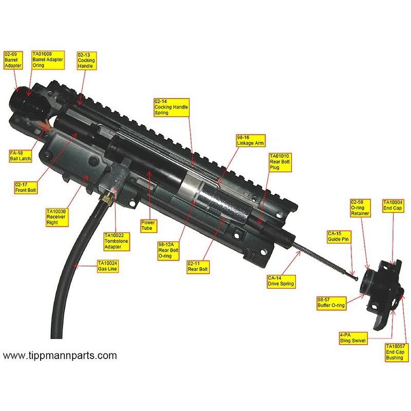

The cocking handle spring will bow out slightly when placed in its milling on the receiver.
This pic shows the internals of an X-7 but it is very similar to an A-5.
hahaha! It was the springs!! I still cant ounderstand how this effects the cyclon feed system....but who cares! Thanx a LOT for the help!
weltmaker2000 called this one
The weaker cocking handle spring wasn't giving the rear bolt enough force to hit the valve pin.
