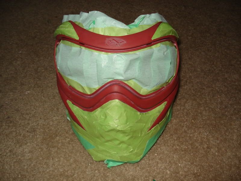

Ok ladies and gentlmen. I have seen a few posts on how to paint masks but it doesn't show the step by step process. So im going to post pictures of the procces a list of materials and if anyone has any questions about it please feel free to pm me.
List of Materials:
Grillz mask
Krylon Fusion for Plastics
Krylon Make it last clear coat(any other clear coats work great but this one is meant for krylon fusion paint.)
3M automotive tape
exacto knife or anyother sort of knife for the tape.
Ok so first you need to take off all the parts of your grill mask.
Next you need to take the tape and start taping what ever you dont want painted.
(note i didnt paint the inside part of the mask cause i was to tired.)
Now that you put the tape on at all the right places. Make sure the tape has not started to unravel. Cause it will.
(make sure you do this outside and put paper down if you need to.)
Now take your krylon Fusion Spray Paint of ANY colour (I chose satan/white)
When your spraying start to one side of the mask. Keep a consistant flow of Spray and spray from about 6-10 inches away.
Wait About an hour and make a second coat. (NOTE: Have this coats NOT thick!!!)
After about another hour. Make a Third coat:
After about 6 hours of drying. Take the Krylon Clear Coat can. And spray exactly the same as how you did the first 3 coats.
Wait another hour after doing the first coat of Clear spray. Then make one more coat.
After that wait about 5 hours and you should be done.
Take off all the tape slowly.
After your done that it should look like this.
Wait a few more days before wearing it, so the fumes can clear.
NOW Your done!!!!!! Hope this helps guys. Again if you have any questions pm me.
Note: I do not take any responsability for any stupidity causing serious injury or death. HAVE FUN GUYS.

do you really have to wait an hour between coats?

Yes, if you dont then you will have a non-dry coat under the coat you just sprayed making it chip.
