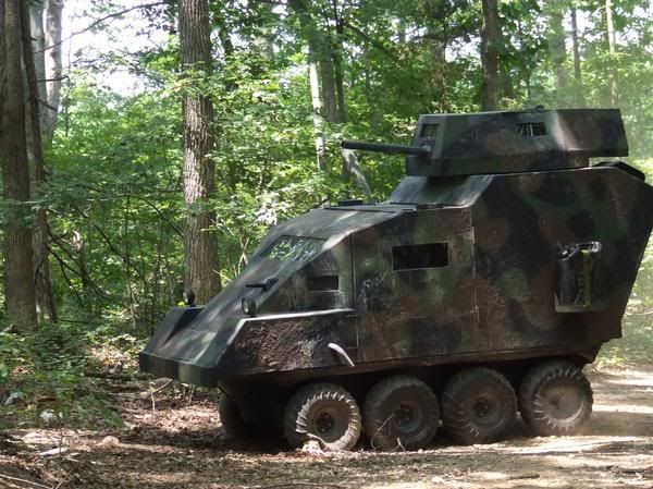

Here is a picture of our sister fields tank. May give you some ideals. (Wolf Creek Paintball, in Star NC)

thats my mental picture right there haha it looked basiclly the same what did they use for windows and what kind of gun is mounted on top

That an air cannon on top. Never really checked out what design he used on the cannon.
His windows are I believe Lexan. Now with his, they are not able to be opened. His windows are secured in place and are not openable. And he did that so he could transport people with out mask on inside the tank. He uses it about as much for parents to get video of their kids playing as he does actual tank duty.
My recomendation, and I think most tankers will back me up on this, is go with paintball netting for your windows. Solid windows like plexi glass and Lexan get covered with paint in a mater of seconds in a fire fight. First thing the crunchies do is try to cover your window with paint so you cant see them and shoot them. Covering the drivers window also means the tank has to stop and clean its window before it can move. And most players go for the gunner and drivers window first thing if they dotn have an AT weapon. They go for it when they do have an AT weapon. Good distration so the AT guy can kill you more easily.
Two of our tanks use lexan windows. But they both flip in, so the driver and gunners can clean them with out having to get out of the tanks. But netting is the way to go. I actually used Pet Screen. Like what you use for windows, doors, and patios so your cat and dog wont tear it up. It very strong and with stod paintball extremly well. But paintballs dont bounce off like they will with paintball netting. They tend to break on the screen and splatter your gunner. And it can make it a little harder to see through if enough gets on the screen. We kept a squirt bottle with water and that handled any vision issues which were rare. The only reason I used the pet screening is I didnt have access to paintball netting. The screen does cost a bit, but you can get it at Lowes or Home Depot.
