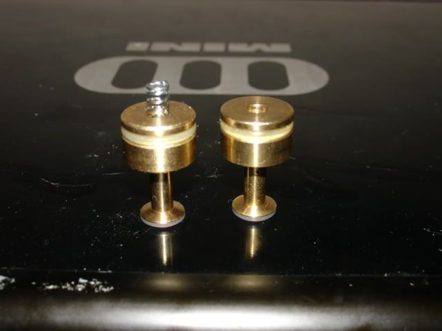

There are 2 1/2 (two and a half) poppet types.
Degas your marker and pull the boltguide out. Screw the backcap out of the boltguide and use an allenkey to push the poppet out of the back of the boltguide.
Inspect you poppet.
The one the the left is the old poppet with the smaller hole. Also notice the diff. in the front seal.
The spring poppet isn't exactly a third gen. poppet. It's a second gen. poppet with a spring and a larger hole (5mm, not 4,5mm) on its backside.
The advantage of the spring poppet is, that it resets itself and saves a picayune amount of air, thus increasing efficiency.

Plus, the spring poppet isn't just like the V2 poppet because the hole in the back is milled out more to accommodate the spring.

i have a v2 and a spring poppet at home, i'll take their sizes when i'm back home and check that. thanks for the info, zachisevil2.

I have a further theory. That there are two versions of poppets but that there are in effect three or more batches of these poppets.
Meaning that there is one batch of V1 poppets made with the small hole...
and that there are two batches (or more) of V2 poppets made with the beveled tips and bigger holes.
One of the V2 batches was defective. I know because my Mini came with one. Even with a clean tip and a clear hole, it kept leaking leaking leaking and I attribute that to a manufacturing defect (invisible to the naked eye) which perhaps canted the stem ever so slightly one way just enough for it sometimes seal but never stay in place when stored.
The other V2 batch works. A last batch of V2 poppets now come with the milled hole in the back to accomodate the spring.
I believe the non-spring poppet is 4.5mm and the spring poppet it 5mm.

The first style poppet itself wasnt defective but some of them were milled wrong and they went ahead and came out with a better design and started making sure they mill the little hole out properly.
