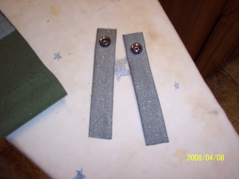

Lets put on the snaps. I'm not giving measure ments on this part. Pictures tell a thousand words. Plus you need to figure stuff out youselves. If someone is going to steal this for an internet book, they'll have to make one and figure out the measurements. Poking the holes in fabric and setting the snaps.
Place the hitting tool under fabric as per directions and hit the snaps as per directions.
Should look like this when finished:
Now fold over the fabric to about 9-3/4 inches:
Pin in place and start setting the MOLLE straps:
First do the snaps:
Do it the same way you did the first set.
