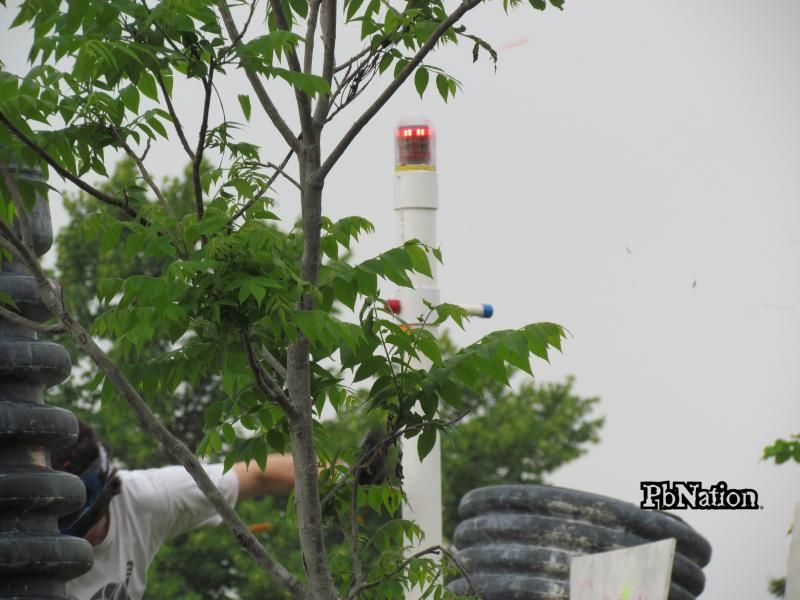

Then there's these that Sean Scott cooked up last year. I took the picture at the PBN/CPX Meet & Greet. Electronic, scores to a laptop, LED lights that change from white (neutral) to red or blue depending on which side pushes the slider. Very cool. I don't know if they every fully finished them, but I think they had some pretty big plans with them. Probably have to reach out to Ryan at CPX now for more details.

Those LEDs are damn slick.
I used 16 Spinners/Sliders and oddly enough the players almost didnt use them to score points... lol

Solar powered slap sticks. They sound expensive, yet they're also extremely awesome.
Is that a plastic light bulb cover on the top? I want to know more about how these work!

Lantern battery, I believe, was the power source. The whole idea was pretty simple and cheap, but development, from my understanding, was complex and costly.
I'd assume the cover is Lexan or something similar.
