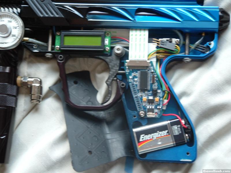

How to convert your gz trigger frame into a lcd clamshell timmy.
Here goes.
1. a Lcd screen
2. lcd membrane
3. 12 point eye harness with 3 plug prong
4. a new trigger
5. screws
7. a lastly a lcd clamshell
all pictures curtesy of www.paintballkingdom.com
and
http://www.technatrigger.com/products/

Should like very similiar to this
