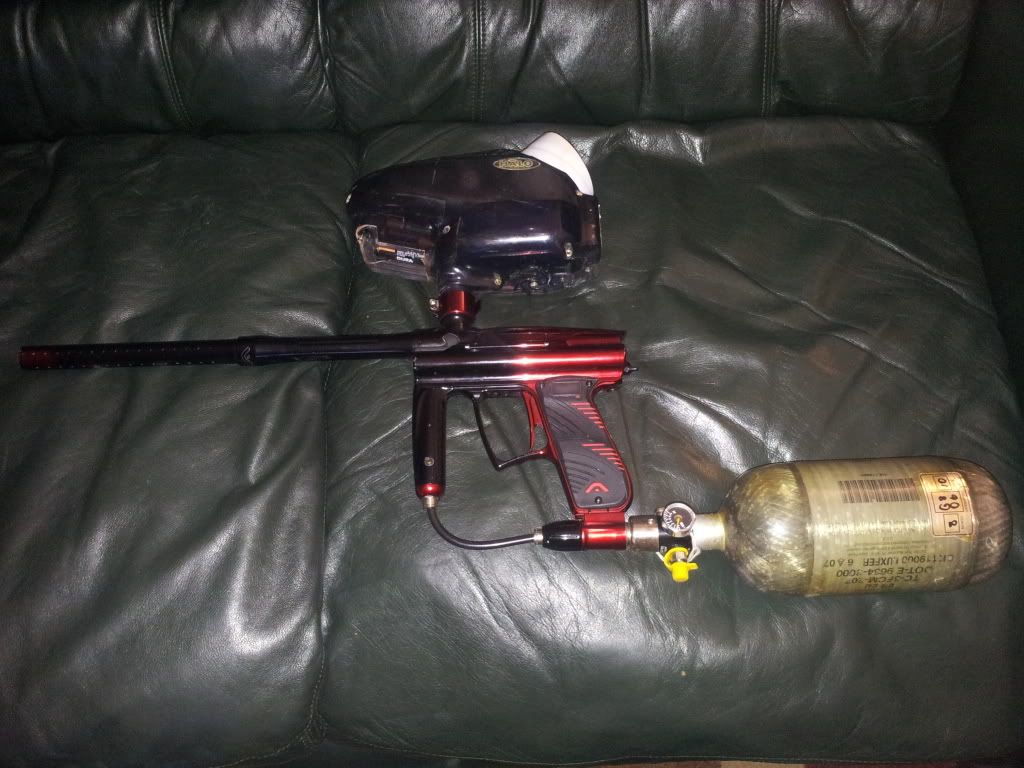

Vdubs (Banned)
Join Date: Oct 2012
Originally Posted by Shocker_Monkey View Post
Nice pick up Vdubs.
Thanks SM Here is everything I got in the trade }:)
