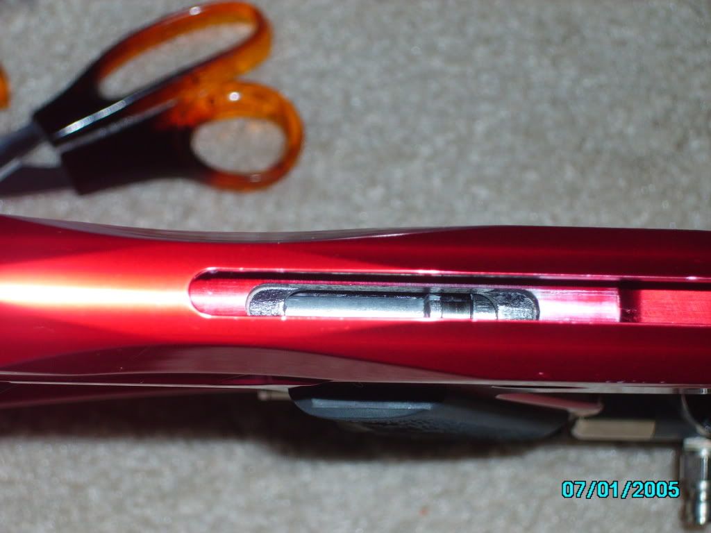

Ok the only possible places for it to leak on a timmy.
Ram o rings
Ram sleeve o rings
Barbs
Poppit
backcap.
Pretty sure its not the backcap or the ram sleeve.
Make sure the poppit has a good seal and is lubed up. Is it using the good old teflon washer poppit system or a one peice system? If you take the frame and air up you will know if its the barbs.
Make sure the barbs have the washers on and arent leaking. And make sure ayou have lubed the ram o ring or try a tid bit of dow55 on them to swell them for now. If that works your ram sleeve is wore out or just has ****ty tolerances.

i think it might be the cup seal....i might have to try that..ill try it tomarow...after school and lax conditionsing...ugh not fun lol....ok well night fellas

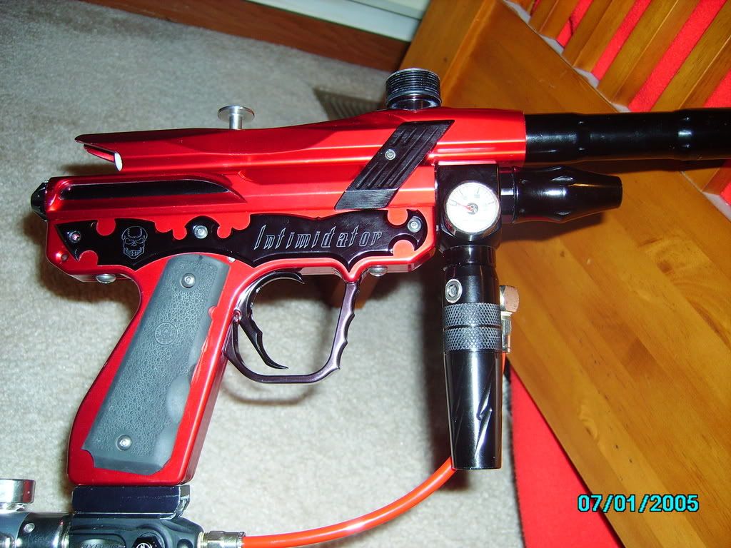

Originally Posted by Up the snake View Post
right side
Left side
where its leaking from
sweet gat man

yea...sweet intimidator....sweet scissors to...lol

Shears look better then the timmy ¬_¬.
