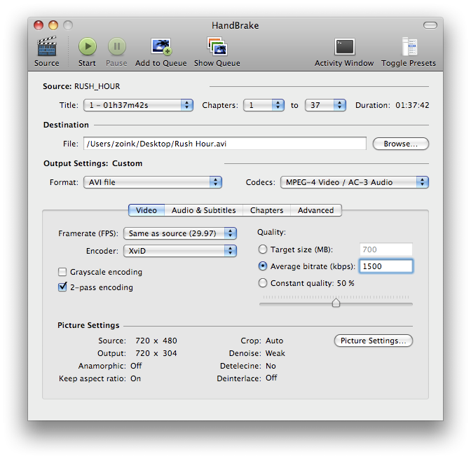

Backing up to Hard Drive: If this is your goal, then you're going to have to decide between movie quality and file size when you go to encode.
**For all movie encodes of this type I recommend keeping the picture settings default. On windows however I believe you have to specify using auto-cropping, which you want.**
This is how mine looks
If your goal is a small file, then I recommend using a Target Size of your choice, in addition to the following settings:
A Target Size of 700mb will give you about the quality of Axxo's movies if you're familiar with his releases. I wouldn't recommend going too far below 700mb.
If your goal is a decently good quality rip, with a relatively short encoding time, and relatively small file size, then I recommend using the following settings.
Here's the windows one for comparison
Where the constant bit rate is anywhere from 1500 - 2000 kbps depending on the quality you want. Increasing the bit rate will increase your file size.

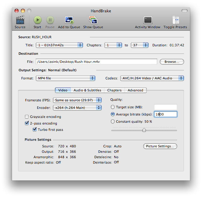

If you decide you want your video quality to be even better, then you're going to want to switch over to the h.264 codec. The encoding times are quite a bit longer (about 1.5 times), and the file sizes are quite a bit bigger (about 1.5 or 2 times for a rip with comparable settings)
The settings I recommend for a standard h.264 rip are as follows, they should be about the same as the "Normal" preset in handbrake with a few minor changes. Also you can change the file type to whatever you please, but if you use .avi you will not be able to use AAC audio. I recommend either .mkv or .mp4 for h.264 encodes.
The advanced settings are left as default.
Again these are just my recommendations to get new people started with using handbrake. Messing around with the settings, especially the advanced h.264 encoder settings is the best way to find out which is best for you. I recommend picking a single chapter in a movie and encoding it a bunch of times with different settings to figure out what you like best.
