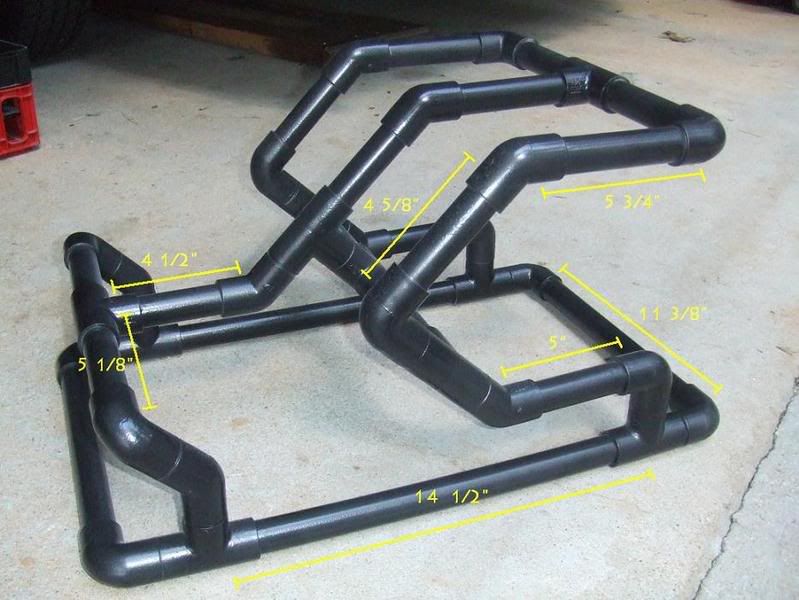

and materials:
What you'll need to make one like mine. All pieces are 1 inch pvc by the way.
4 90 degree elbows (all for stand)
2 90 degree elbows with 1 male 1 female ends (thats the back part of the tank rest to get it to fit into the adapter)
2 45 degree elbows (barrel neck)(works better then a normal neck cause you can off set the slant inside the hopper to fully fill it without having to pick it up)
6 T pieces (1 cut in half for the barrel. 1 cut down to slim the pod holder)
10 3 way 90 degree elbows (2 for stand 8 for pod holder)
10 3 way adapters (for some reason no one makes a 3 way with all 3 ends the same. 1 end allways has a thread inside so you can drill it out but it's far more easier to just buy the adapters)
1 standard length pvc pipe (think most sell standard lengths at 6 ft or maybee it was 8. Eighther way it's way more then enough)
1 standard legnth of pvc pipe insulation.
1 partrige in a pear tree.
1 can high gloss spray paint.
BlueImpulse's gun stand
and plans
parts list:
12’ of 3/4" PVC pipe
7/8" ID pipe insulation (self-adhering)
Handsaw/Miter Box
PVC Cement
Tape or Zip Ties
Fittings used (3/4" ID):
90° Elbows - 12
45° Elbows - 8
Tees - 8
Other items I found useful:
Dedicated pipe cutting tool
Rubber Mallet
Cost: $15-$20 for the materials (excluding tools, PVC cement, and primer/paint)
The measurements shown include and extra 7/8" on each end in order to connect the fittings, so cut your pipe to the measurements shown. Also, there are small, 1 3/4" long sections of pipe connecting the flush mount fittings.

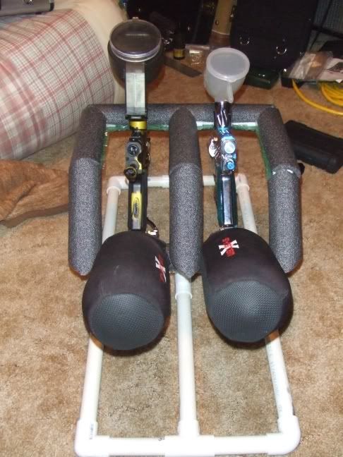

my stand
made from pvc and foldable
