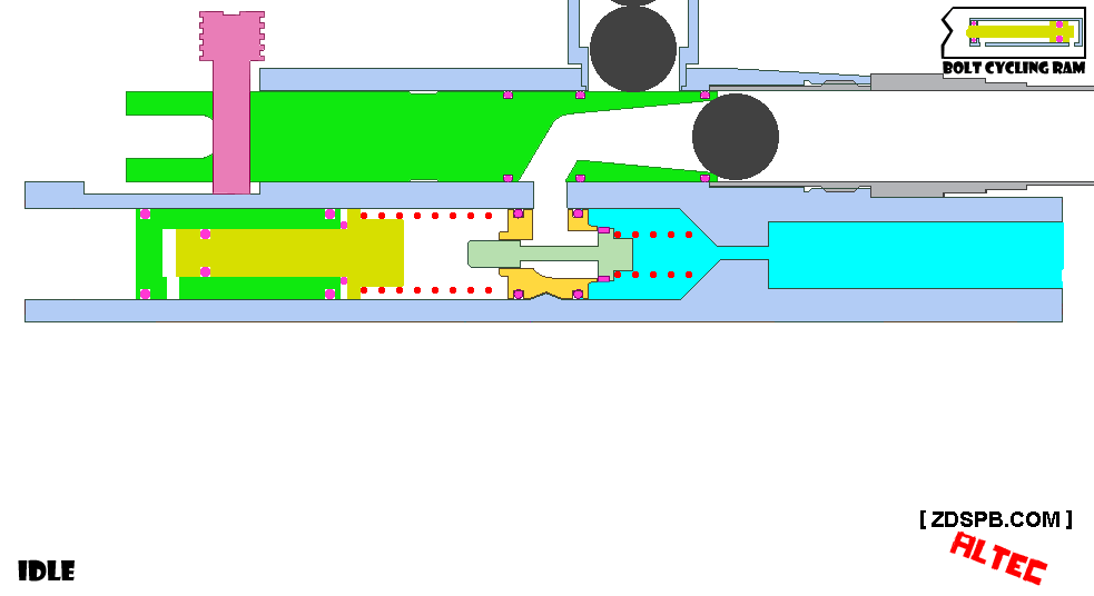

hows an osiris work
so i know the top lpr is for the front noid.
and somone told me the bottom one is for the back noid.
back noid????? so they werent sear trippers like other cockers?
did they have an mq or were they fully ep in a different way?

They are FASOR style markers.

yeah, I believe instead of having a spring pushing a hammer into the valve, they had a ram, which the second LP ran. I've never held one, but from what I've seen of them that's how they worked.

The bolt is manipulated by a uber low-pressure ram, autococker style. And the valve-actuation methood is FASOR, just like in the Legend, Fusion, and Wrath. The second LPR is of higher pressure to run the ram.

its pretty damn clever.

A quick photoshop of how it works. I may make a hole new one later. Send it to Ydna.

You should edit that to make it look like it was turtled.

hey! I'll add that...

Heres the second try. Ydna, hope you don't mind I used your Excal .gif to make it. If you do, just let me know, I'll delete it.
Still a little more tweaking needed. I need to slow it down, clean the bolt up a little, and add more then a couple MS of "idle" lol.

Do you think you could add a little mechanism that moves the bolt? Besides for that it looks pretty good (good enough as it is...but people stil might have questions).

I think what I'll do is make a cut out window in the top right corner showing a ram. I also noticed something. The O-ring on the ram isn't there.
I'll start on it later tonight.

Ok, here we go. I think it looks better.
