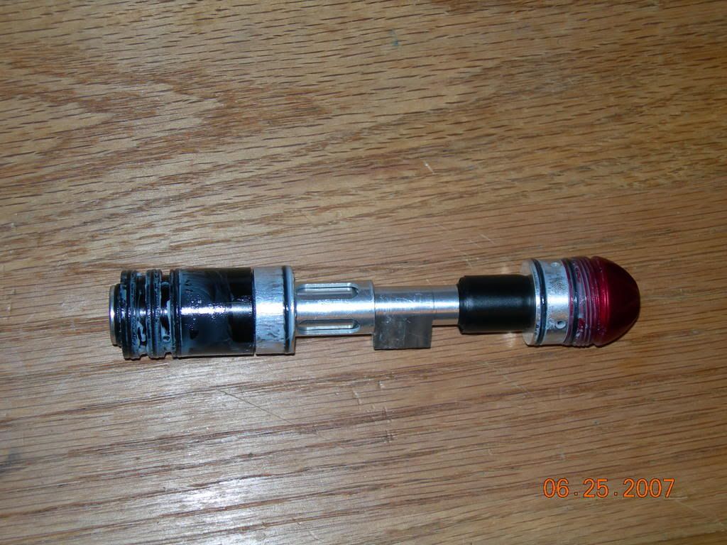

What this mod will most likely do for you:
quieter shot(not by much)
less kick(noticeable but not huge difference)
more consistant/accurate(ball on ball)
and possibly if your lucky more efficiency(it worked for me)
i was messing around with my pmr tonite and was wondering if a sort of tophat mod would work with my gun. i took the bolt guide out and on the manifold near the back cap (as far as i could go) i put electrical tape about 1/4 the way up the back wall and also lowered my dwell to 18. i went out to test it and i was getting about a hopper off 400-500 psi!(is that better) i also noticed that the gun was a little quieter (for those of you that care about noise.) the gun also had less kick, it was more consistant and had no drop off. i also have my reg well broken in so im not sure how this will work with a brand new pmr. well i just thought id put this out there that it does work and it will improve your guns performance.

Does the PMR bolt have tophat?
Post the pics... be interesting when others test this mod out.

i can post pics tommorrow and no the pmr doesnt have a tophat (i know you were being sarcastic but others might not)

pics are here
sorry for the bad quality but my camera sucks

Did you notice if you had to raise or lower your HPR after doing the mod? Have you chrono'd it after doing the mod? Interesting mod.... post what you find.

not being a dick, but tips to take better pics in the future:
im guessing your camera is a point and shoot, so you should back it away a few feet from the bolt, and crop the pictures, if you know how.
The first two pics are out of focus because the camera is too close too the bolt, and it cant focus.
Thats all, otherwise, ill try out the mod.

i did this mod at my house so i didnt have a chance to crono it yet but it seems like it doesnt need much ajustmant maybe a little higher on the hpr but not much
to beef is good i know that the camera was to close but i was trying to take them fast b/c my batterys were dying and regular batts wont work but ill take better pics tomm thanks for the tips though.
