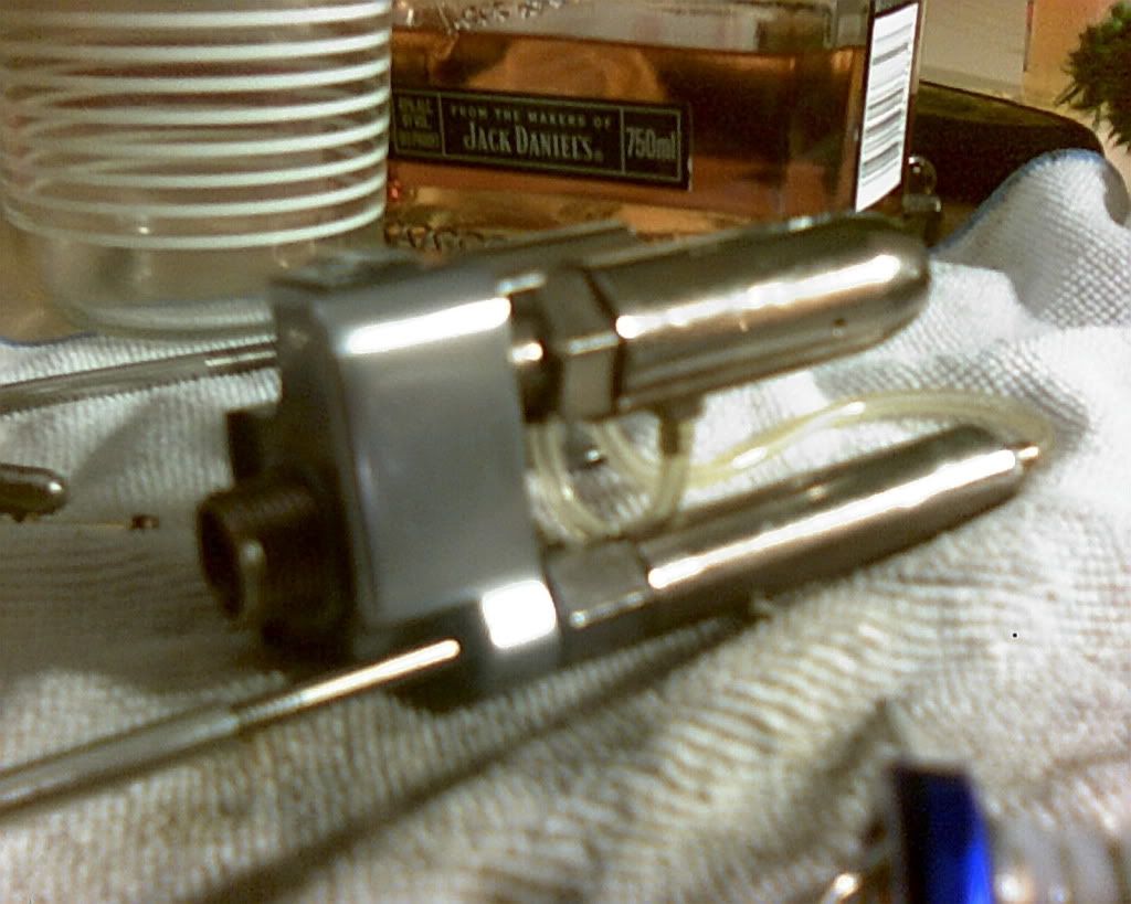

Here is how it sits now. Wasn't as bad as I thought it was going to be, pretty straight forward. I'm not going to polish it if its cleared, don't want to burn through the finish. I can't find a scratch on it.

How much of a disaster would it be if I pulled the pneumatics apart to polish them? This is literally the first time I have ever even turned a screw on a Cocker. I don't want to completely screw it up, I want to play with it this weekend.

Your going to have to re-time it anyways after taking it apart. Wont hurt to break down the pneu's too.

Guess I'll do it then. I've been polishing it for the last couple hours, inside and out. Under the grips the chrome is bubbling in two small places. The guy apparently tried to blend a smoothie in the breach and didn't clean up afterwards. Took forever to get it clean. By the way, I really hate that 12 point bolt holding the vert on.

i think wgp called it "titanium", but technically yes its just a clear anno after the metal has been polished. the other parts are chrome or nickel plated.
wgp's guns were always pretty solid stock, the reg is adjustable, just not externally. honestly the only things id change would be to get a delrin bolt, a nicer asa, and lose the drop. maybe another reg if you just want the convenience.
the feedneck may or may not be removeable, i think the later runs of the 04's came with a removeable one. if you look upwards at the bottom of the "pipe" part and it looks like theres a seam, its probably removable. if it looks like one solid piece, it probably is.
some watered down rubbing alcohol is great for cleaning up old gunk, clearns off the yucky residue's too.....i always kept a little spray bottle of it for cleaning guns after playing.
check out www.customcockers.com for a timing guide. also id put a little grease on the 3-way o-rings while you have it apart, otherwise all it should need is a few drops of oil right in the asa every now and then.

Drop forward isn't going back on when I'm done polishing. My hands are freaking killing me and my Dremel is smoking. I hate polishing but I love looking at it.

Well the body, barrel and frame are done. Just the pneumatics left. This bolt feels extremely heavy. I polished it up and its smooth as glass, just seems heavy.
