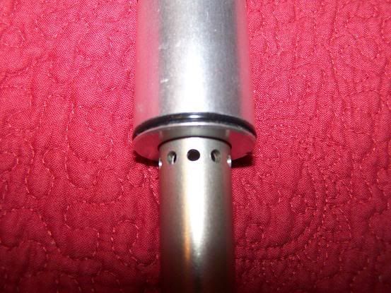

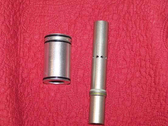

Smart Parts Shocker SFT stock bolt:
-This is the bolt that comes stock in the SFTs from year 2003-2006.
-The bolt has horrible effiency.
Smart Parts Shocker SFT stock bolt Identification:
-It has small, circular holes on the bolt.
-The bolt can easily be removed from the can (slides out).
-The fire chamber is one-piece, it doesn't come apart.
-Anodized different shades of gray/green/blue, or clear-coat silver.

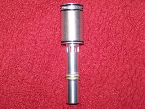

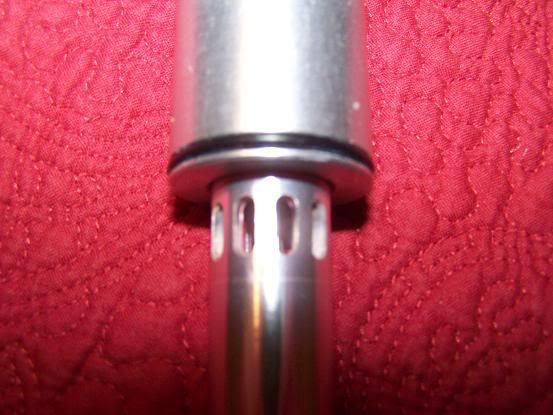

Smart Parts Shocker Turbocharger (HE) bolt:
-It is an upgrade for the SFTs, and it comes stock in the new NXTs.
-It greatly increase effiency in your Shocker.
Smart Parts Shocker Turbocharger (HE) bolt Identification:
-It has elongated, ovular holes on the bolt.
-The bolt has to have an o-ring removed to be taken out the can.
-The front/cap of the fire chamber can be removed for disassembly.

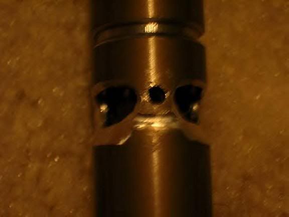

StrangBalla55 Shocker stock bolt mod:
-Sayed to have effiency like the Smarts Parts HE bolt.
-You need a Dremel and patience to do this mod.
