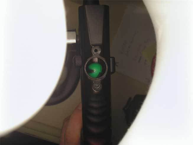

here we go
bolt cocked
ball on detent
ball on bolt.

Ok, thats NOT the detent. The pics really do help. Tho, why its not ending even with the breech, I'm not sure. But yeah, the bolt should be even with the edge of the feedneck.
you said that it cocks like that, even with the stock bolt? And with a different striker?

yep tryed a stock bolt, and a different stock striker. same problem!
maybe the body is screwed up some how.
