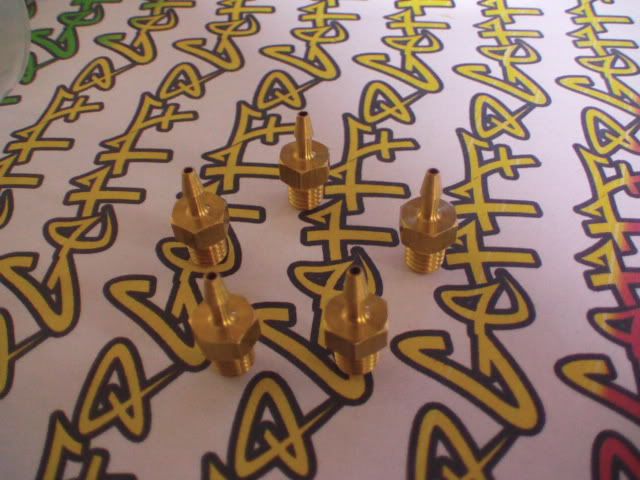

bought enough supplies to make 4 of these, will post pics and maybe a video
12-31-08:
Got my barbs in today:
