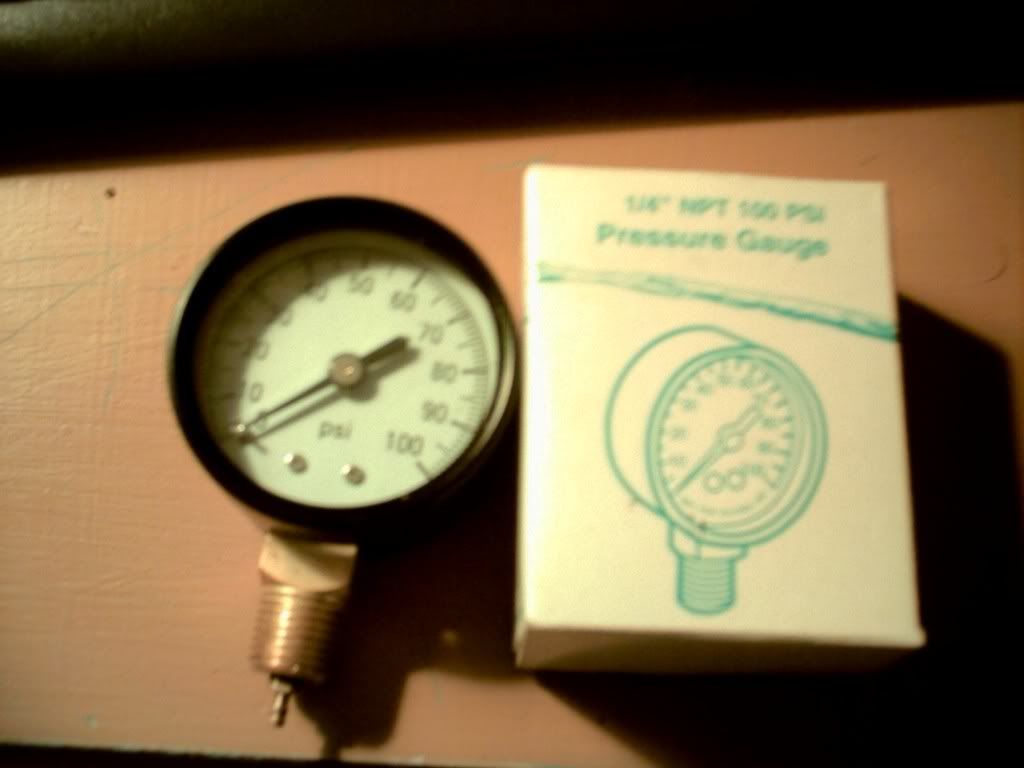

Should be in a white box with Teal/light blue lettering says not for oxygen but I have been using it all day fine and I Don't think my mom was right on the price it doesnt look like it was expensive but then again its a VERY accurate gauge DON'T loctite the barb unless you want to degas your gun every time the timmy fiber washer seals it fine and whenever u wish to reset the pressure on the gauge you unscrew the barb a bit

This idea would also be great for anyone who has a 0-300psi mini gauge. Since they are so hard to read, this would allow someone to save $5 instead of spending $15-$20 on a macdev or cp mini which reads beloew 160psi. Awsome idea.

how is the air bled? most of these I've seen online has some sort of bleed valve.
great idea, nonetheless. I need to make one for myself.
bimbot is offline   Reply With Quote
Old 02-02-2007, 04:24 PM #38
hopelessandsic
mynameissprinkle
hopelessandsic's Avatar
Join Date: Dec 2003
You have to turn off your airsource. This doesn't have a bleeder, remember, this was meant to be cheaper than an LPR tool.

Originally Posted by paintballeruknow View Post
ProPlumber Lowe's ID No. 64124
1/4" NPT 100psi
Pressure Gauge
so, you get this gauge at Lowes and where do you get the barb?

any paintball store. It's a standard autococker barb.
My Lowes didnt have that guage only the one that I showed in the post. It depends on your store.
