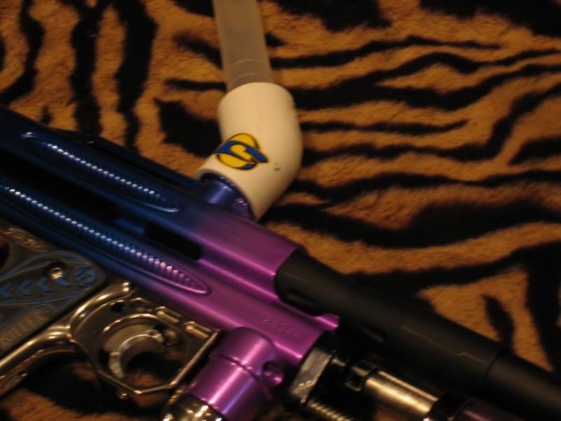

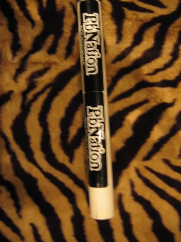

1. Get elbow and shove pvc onto it
2. cut the pvc pipe FLUSH with the elbow, it will look like this
3. sand a lip inside the PVC you just put into the elbow with sandpaper, dremel etc. it will look like this
4. keep sanding until a ten round tube slides in and stays in with relative ease

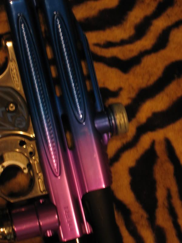

ok, using PVC for this is really only the BEST way if you have a cocker with a threaded feedneck, like so
the elbows will slide over the threads, and depending on the size of the PVC, may require you to put some electrical tape over the threads.
