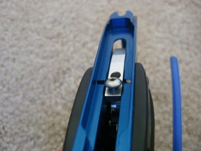

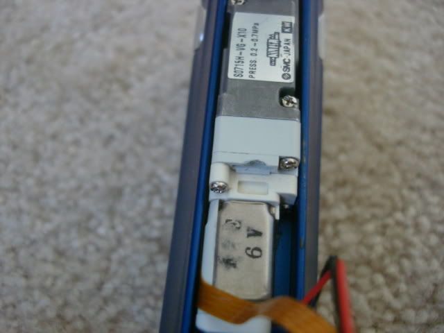

***I played all day on Saturday and ran into a problem with the trigger on my M7 with a stock frame. The over travel set screw uses the plastic part of the solenoid as the post activation trigger adjustment stop. The set screw digs into the little lip on the solenoid and would stick on every pull. It was an easy fix just get one of the grip screws from a repair kit and use it instead of the set screw. Hope this helps anyone who runs into a similar problem.
Solenoid, the half round indent in the center of the solenoid is where the set screw wore into it and started to stick on every pull of the trigger.
Screw From 45 grip instead of set screw
You may have to sand/file/grind the edges of the screw slightly for it to fit into the frame properly.
