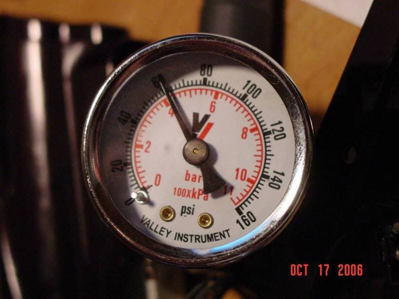

I was poking around on Ebay, and it looks like someone has already made a LPR tool for the ONYX.

Thanks for the info, I just bought one. I'll let you know how it works.

Yeah, I got it on Tuseday and it works great!!! I'll post some pics in a little while.

Here you go, enjoy!
