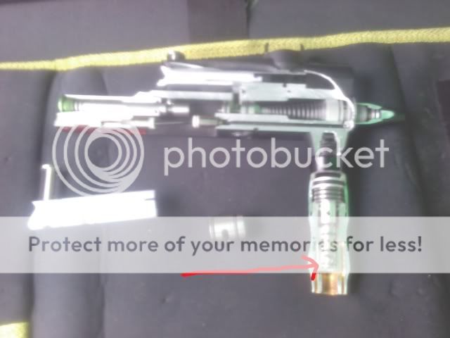

I got my indy annod and took it out to play but never could get it to chrono past 220.
Im guessing i might have put the shims in the hpr on wrong?
they are like )()()(.
dwell- 12
lpr- 1 turn out from flush
hpr- I start from 0 and it never gets higher than 220.
Anything else? Everything been lubed. TWO brand new batteries. Iv'e upped the dwell and lowered the dwell. Upped the lpr and lowered it. Still nothing
dwell- 12
If you or a buddy have a spare reg I would put it on and see - start there

I put on a hyper2 and got it to about 280 when it was all the way up....
Anything else i can try?
Is there any reason why the stock reg wouldn't get up to pressure?

balnce both reg see if that help any

Well i think i MIGHT have found my problem. I found a little spacer washer that goes in the very bottom of the reg but don't have air to test it. Would that possibly cause the gun not to be able to chrono up to 300?

Yup, that spacer goes in the reg up near the top(if the reg is on the gun). It should have the bend facing down. It sort of holds the rest of the guts in. If it's not in properly you won't have the same tension on your shim stack and that can cause the problem for sure.

Not the Shim that's on top of the piston.
Its like below the ball bearing at the very bottom.
