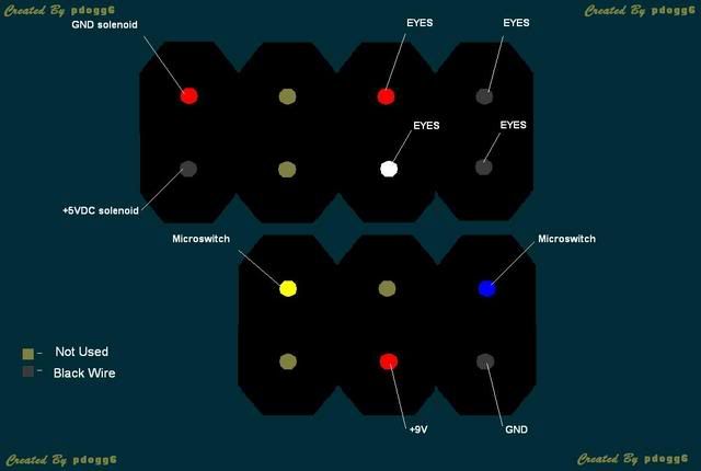

Wiring Diagram for 05/06 Aliens w/WAS board:
