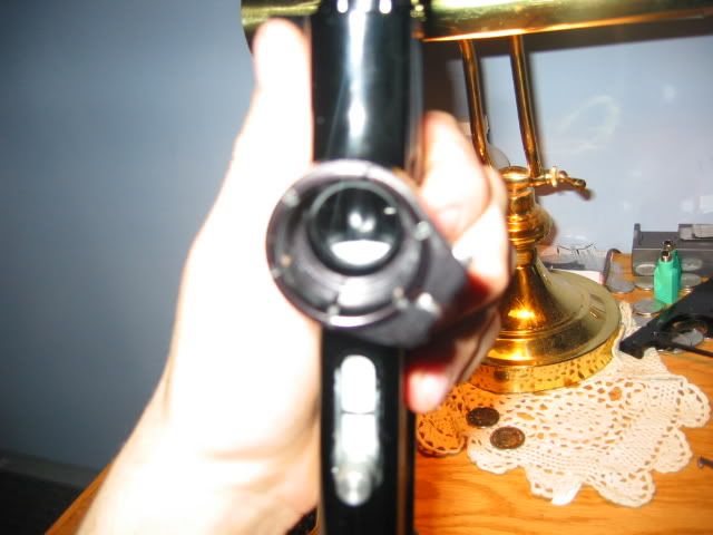

it works on mine, did you cut the stem off??? and wit that bumper its supposed to be 1/16 of an inch away fro mthe hammer housing so that it doesn't make wacking noises when the hammer hits it, and it also evens the bolt with the end of the feedneck, i stated this at the beginning. its liek addign a ram bumper but on the inside of the housing
and the bushmaster ram won't fit in the promaster, the piston part of the rod is bigger then the promasters, so they won't fit
EDIT: pics with the mod in and bolt in, this mod will also keep the pin from hittign the back of the slot and making noise as well as stop burs from forming
