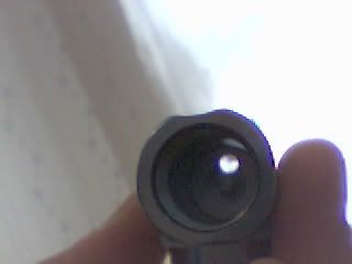

Agitator bolt!! put o-rings on a ham and egger delrin bolt
Turn your delrin-bolt without o-rings into a gas-efficient o-ring bolt! Also- you can remove that pesky built in venturi found in shocktech pre-alias bolts! I made my detent groove as big as the dragun stock bolt has, so it wonít trash the ball detent! Read-on.
DONíT BLAME ME IF YOU HAVE TROUBLE DOING THIS/MESS-UP YOUR MARKER AND/OR TOOLS IN THE PROCESS! I AM PROVIDING HINTS AND SUGGESTIONS ON HOW TO IMPROVE YOUR MARKER. BE SMART. IF SOMETHING DOESNíT SEEM LIKE A GOOD IDEA, ITíS YOUR RESPONSIBILITY TO MAKE THE CALL.
I am not responsible for any damages you may do to your property*
What you need:
ANY crappy delrin bolt w/o o-rings
A drill (not absolutely necessary) and a few bits, or a pencil.
A dremel (>god) and tips
Safety glasses
VENTURI REMOVAL:
The venturi is the star thing in the end of the bolt. It supposedly reduces turbulence. Youíll notice high-end bolts donít have it. Itís old technology. It restricts air flow. TAKE IT OUT!
1. Take a dremel, get a cutter like this:
2. Chow-away at the venturi, being careful not to cut into the outside walls of the bolt:
Wear safety glasses!
3. Get an abrasive stone that will fit inside the end of the bolt. Run it around gently to de-burr and smooth the inside of the bolt so air can flow well.
It should look like this when youíre done:
Thatís it! Just wash the bolt to get-rid of the delrin filings. Also- you can get-rid of an aluminum venturi by un-screwing it with long needle-nose pliers. If itís an aluminum bolt with a bunch of holes, the above method should work*
O-RING GROOVES!!! YEAH, BABY!
Though people have probably done this, Iím the first one I know of, so I call it the agitator mod, lol!
One note before you start this awesome mod. If you start with a bolt thatís too thin, you may weaken it excessively and cause it to break once you start using it. Iíll let you guys know how mine works out, but I havenít, at this time, thoroughly tested it.
1. Chuck a large drill bit into your drill (you canít do this, unless you have a bolt without a venturi). Wrap the bit in a rag and stick it snugly into the front of the bolt: (I disassembled mine to do this, but you donít have to if your bolt is a one-piece one... thatís no problem.)
2. Make sure the bolt is centered ie; when the drill turns, the bolt doesnít move from side to side. This will ensure that the grooves are the same depth all the way around. This step is very important. If you donít have a drill, you can rotate the bolt by hand while dremeling. This will take more time/effort and probably wonít be as good. Then again- not all of us have drills.
3. Put a cut-off wheel on a mandrel and chuck it into your dremelís collet. Wear safety glasses! On a slow speed (3/5), cut into the material on either side of the air inlet as the drill rotates at a slow speed. Go slowly and make sure you donít cut too deep, or your bolt will break in half, which is bad! To make a wider groove, turn the dremel, so the wheel is rotating on a different axis than that of the bolt. If you donít know what I mean, feel free to pm me about it. I started on the forward groove of the two, since the seal of that particular ring isnít as important as far as blow-by is concerned.
It should look like this:
4. Do the other groove, and make both grooves a little shallow. Test fit Ďem a few times and take the material off slowly. The bolt should fit in the gunís bore snugly, but it should be effortless to slide it. There shouldnít be any free play and the bolt should drop outtaí the gun if you tip it... You donít want a lot of friction.
5. Once the grooves are the right width/depth, wash+dry the bolt and re-install it. Also- if you do make the grooves a little too deep, wrap some teflon tape in the grooves to act as a shim. This will make the o-rings tight enough again*

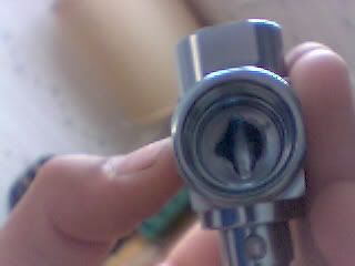

Hi-flowing vertical adapter
Sorry to double post, but these are two separate guides.
Also- I know you guys know this stuff, but there may be a new dragun owner who doesn't
Hereís how to modify a vertical adapter to be high flowing. I know that others, such as otter have tutorials like this. Iím not trying to claim that Iím the pioneer of this idea. I just wanted to have some fun, do some drilling, and take some pictures of it!
Turn your va from this:
To this!
What youíll need:
A drill with a chuck big enough to hold a 3/8" drill bit
A wide variety of drill bit sizes
A vertical adapter with enough chunky-ness to be over-bored
Teflon tape
A spring for a tes style marker, or a maddman rocket valve (Iíll explain why)
1. Make sure your marker is de-pressurized and turned-off. Remove the hose and foregrip/regulator from the vertical adapter. If you donít know how to do this, you should check-out ottersccustoms.com for info on marker disassembly (he also has a lot of tutorials). Using an allen wrench, take the bolt out of the bottom of the vertical adapter/gun body. Slide the vertical adapter out of the front tube. Remove the volumizer and o-rings.
2. Choose the right size drill bit and chuck it into your drill. Make sure the drill is in forward.
Itís a good idea to put the piece youíre drilling into a piece of cloth, then a vice, so it stays in one place, but itís your decision. I chose to drill-out the center pin-pusher for vercical set-ups, using a 3/32" drill bit. This helped center the larger bit. This is how it looked after doing that:
3. Now- make-sure you donít drill-away the part the o-ring of the foregrip/volumizer(front) seats on. If youíre in doubt, feel free to pm me and ask about it, instead of proceeding and causing a leak* The drill may get bound-up on the smaller holes that are already there. Take it slow and try not to jam the drill/snap the bit. If it gets stuck, stop. Get it out manually, and either try a smaller bit and work your way up in sizes or switch to a dremel with an abrasive stone. That is what I did. As you can see, the hole isnít perfectly round because I didnít want to use a whole dremel tip on this one modification.
4. Drill down through the vertical adapter from the valve-end (part that sticks into the gun) to the volumizer end. You can use a bit that will remove all the material in the hole, but the valve spring sits on the metal, so this will cause a problem, unless you have a rocket valve. The rocket valve has a self-contained return spring, so this isnít an issue. The same goes for the wide-end of a dragun tes style spring. Make-sure you drill straight through. The bit will want to center on the old hole, which is a problem. If you let it, you may break-through the wall where the o-ring grooves are, which is bad. If you finish drilling and the bit wants to stick at the end, take it out and use a dremel with a triangular stone from the volumizer end. Be careful not to damage the inside threads and/or smooth, large area.
5. WASH AND DRY THE PARTS. Metal filings wreak havoc on o-rings, so be sure to get Ďem all off (the kitchen sink sprayer works well). Wipe the va dry with a rag to remove any additional filings. Then, put the o-rings back on. Put everything back together and USE TEFLON TAPE ON THE SCREW THAT HOLDS THE VA ON, otherwise the screw will leak.
6. You should notice an increase in the markerís velocity.
