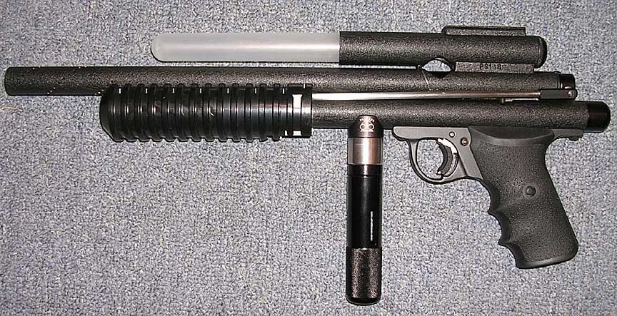

Here is a nice Custom Superstocker next to a Stock one

WOW! now i see the difference! how's the 45 frame? very nice!

the top SS in himurax' pic is actually a classic pattern finish of paint splotches.
even before he added to it, it was very expensive....
this is what it looked like when i owned it...

AHH!! ok, cool! now is it true that there are differnet valves? those two previously mentioned?
...if you don't mind me asking, what's up with the pump rod? it's very unique!
×ËvîLšLÂVë× is offline

evilslave, i'm assuming the two different types of valves really wouldn't apply to a super stocker.
you'd be running either 12 grams or a 4oz...
the offset feedtube requires the ball detente at an odd location, hence the angled pump rod.
