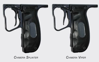

There are "Chimera" frames from www.themagsmith.com
Standard Features:
~AGD styled trigger guard
~AGD Safety Mechanism
~AGD Intelli-Feed Bracket
~ULE weight reduction
~Trigger Guard Slot(for easy frame screw removal)
(PIcture and specs from www.themagsmith.com)

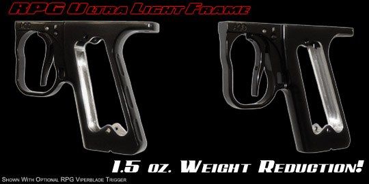

Rouge Has stunned us again with the ULF ( Ultra Light Frame). IT has a 1.5 oz weight reduction over stock intelliframes.
(picture from RogueFactor)

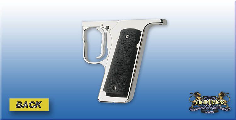

Straight from AGD comes the intelliframe. "Packaged STOCK with black DYE grips and your choice of Blade or Double Triggers. Comes in hand-polished black, matte black, or for a little more you can look good in chrome! This beauty is machined out of a solid block of aluminum and takes over 35 tools to produce. Regular versions (the first 6 listed) fit the Automag, Pro Classic, Minimag, RT Pro and RT ULE Custom.
If you own an Automag RT, be sure to select an RT version (last 6 in the list). DO NOT buy an RT version if you own an RT Pro - these are only for the old Automag RT."
(picture and description from www.airgun.com)

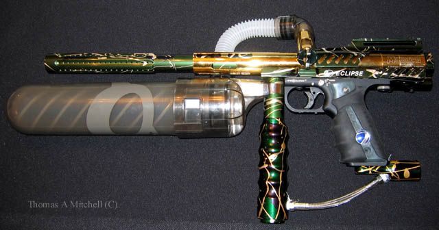

This is a frame that will fire your Mag when you pull, and release the trigger. They are discontinued, and used cost about $200. These are not field legal.
(UThomas' AR Framed Mag)
Video of UThomas' AR Framed Mag:
http://home.comcast.net/~thomas_mitc...toresponse.wmv

In the modern world of electros the anti-chop method of choice is eyes. With some electro conversions Eyes can be added to automags. It will require you to drill a hole in the body and fashon some eye covers. X-Mags come stock with an ACE board, there are ones made for mags, but they are rare and hard to find. The E-Mag Predator boards also have ACE, but those still arn't out.
Spydermags can be T-boarded which can accept eyes.
Logic's Electromag frame can accept eyes.
Devilmags can accept eyes.
iMags can accept eyes.

Weight Reduction
In addition to being slow and chopping machines Mags are also "Teh heavy Br1ckzorz!!!eleventy-two!111." AGD has come out with ULE products that greatly reduce the weight of Automags.
Most parts of a Mag can ULE'd
1. Bodies
2. Rails
3. Grip Frames

3. Grip Frames
The lightest grip frames you will find for
Mech: RPG ULF
RPG Chimera Frame
Electro: You can have E-Mag frames ULE'd, removing all non-essential metal, making your E-Mag slightly lighter. E-mag Battery packs can also be milled to reduce weight.
End of Weight Reduction

THE KAMKA has achieved Level 2 in PbNation Pursuit
THE KAMKA has achieved Level 3 in PbNation Pursuit
i got the mq mag
Sexy gloss black ninja mechmag and a ws66 m4
THE KAMKA is offline
Old 12-06-2005, 07:19 AM #20
Arstron
fusionowners.org
Arstron's Avatar
Location: missouri
oooh, first picture ive seen of the mq mag. Have you actualy played with it, and if so how do you like it?
