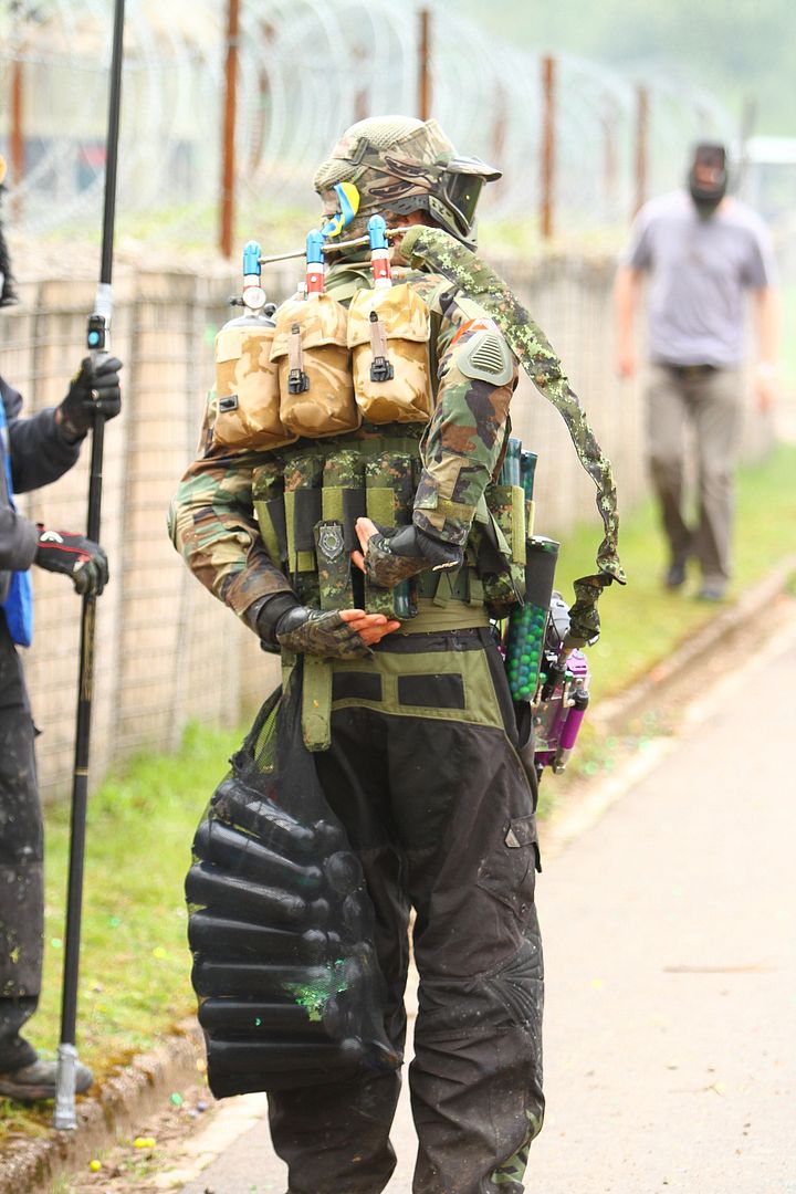

Originally Posted by Devlin123 View Post
this might be a dumb question, but couldn't you just hook up your spare tank directly to your other by using a remote hooked to its fillnipple?
Not on any regulator setup I know of.
Anything connected to the fill nipple port on a preset tank regulator is going to be hit with full bottle pressure, so up to 4500 or 3000 psi. Not only would it be unsafe to walk around with a line pressurized with that much pressure, I don't even know where such a line would lead to. You couldn't just introduce it into the output line going to the gun(s), and I don't know of a way to reduce or send it through the other tank's regulator without running it into that tank's fill nipple or gauge port. At that point, how would either tank have been filled in the first place?
It would be much safer to have the tanks communicate downstream of their regulators.
Odjur's setup:

That's fxxxxxx sick!!!!!!!

Originally Posted by The Inflicted View Post
Not on any regulator setup I know of. Anything connected to the fill nipple port on a preset tank regulator is going to be hit with full bottle pressure, so up to 4500 or 3000 psi. Not only would it be unsafe to walk around with a line pressurized with that much pressure, I don't even know where such a line would lead to. You couldn't just introduce it into the output line going to the gun(s), and I don't know of a way to reduce or send it through the other tank's regulator without running it into that tank's fill nipple or gauge port. At that point, how would either tank have been filled in the first place? It would be much safer to have the tanks communicate downstream of their regulators. Odjur's setup:
that setup is crazy. Wouldn't want to run into him...but I'd follow him ha!
