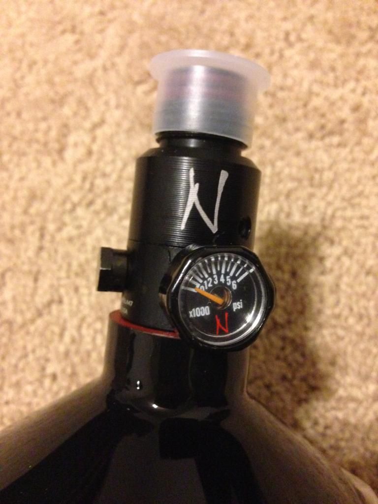

Old 07-30-2014, 11:05 AM #1097
Nate @ Ninja PB
Ninja Paintball
Nate @ Ninja PB's Avatar
Location: Illinois
Nate @ Ninja PB works for a Paintball manufacturer
Nate @ Ninja PB is playing at Living Legends V
Nate @ Ninja PB is playing at Living Legends VIII
Nate @ Ninja PB owns a Planet Eclipse Geo
Originally Posted by Stevenchen0616 View Post
@ Ninja
Does now ALL ninja regs are equipped with the following:
1. ball valve seals in stead of pins
2. Aluminum bonnets from standard to pro
3. Nano gauges
Because the local shop sold me this tank as claimed "Ultra Light reg". Please kindly advise.
All Ninja regs are equipped with the high flow ball now.
The Standard reg is equipped with an alloy bonnet, standard gauge and ball valve.
The UL and PRO reg are equipped with an aluminum bonnet, mini gauge and ball valve.
From the picture you sent that looks to be an Ultralite regulator
sorry but Nate has moved on from ninja
please send any PM to Help @ Ninja PB
or post it in the ask a ninja tech thread in the air forum
