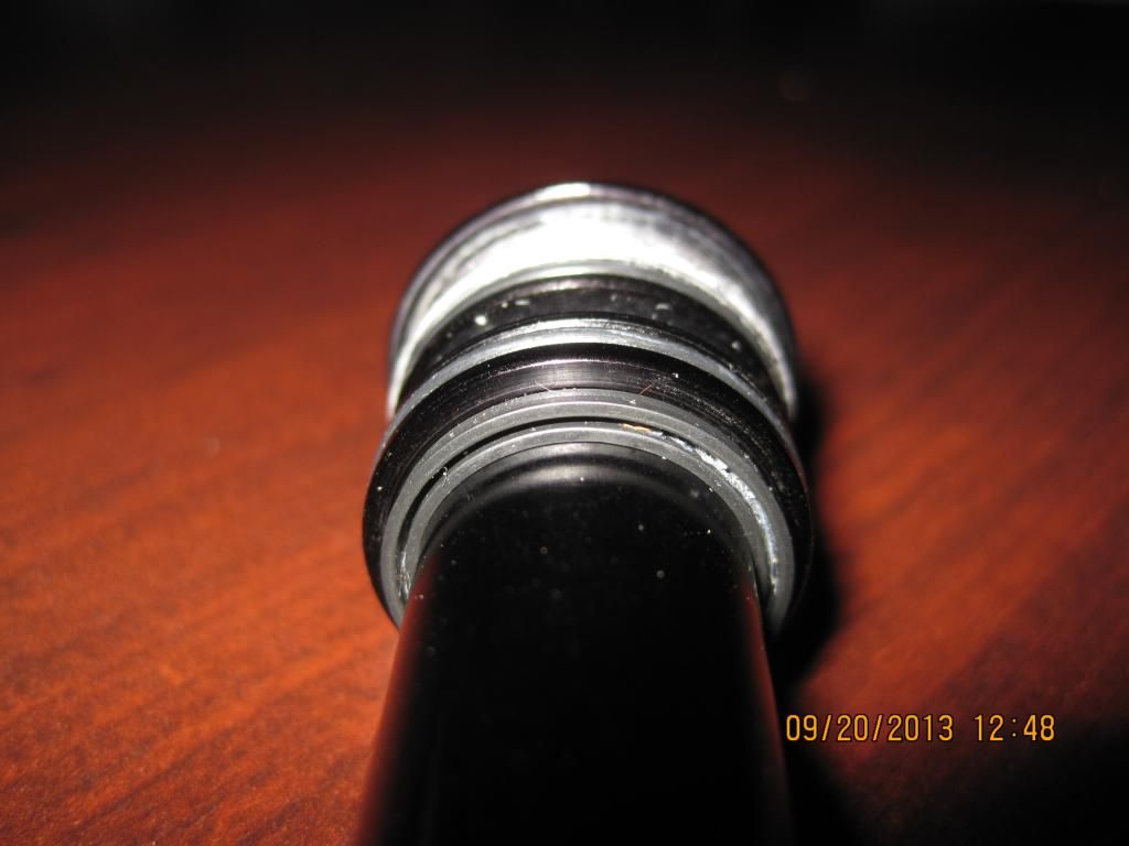

Red face back bumper with anti bolt stick grooves
found some square orings with the size of the back bumper
I made some grooves so the air to prevent the bolt stick with the bumper
it shot like butta with rebals
tomorrow Ill do a field test with the gray quest
OK the best bumper Ive got for stock snatch pin is the timmy V front ram sleeve oring, This has the lowest no bolt stick

Great idea, I actually wonder about little grooves on the bolt instead for bumper life?
What do you think Juit?

that would work bro, I would deff do it to my marker, some guys dont like the idea of cutting metal but you know me I dont mind

This Mod works even better with a 50 durometer 111 oring that has some notches cut into it.
All credit to Juit though I just went off of what he had going on.
