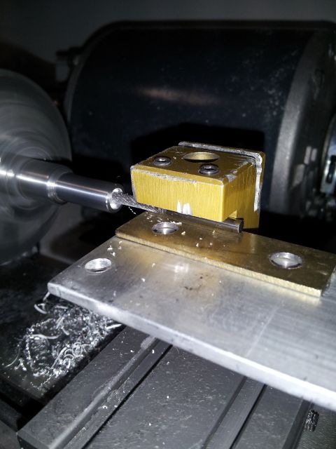

Finshed up the latest test parts. Bout to tune and get a vid up shortly.
In the mean time disnt have a drill bit the right size so had to come up with something else.
