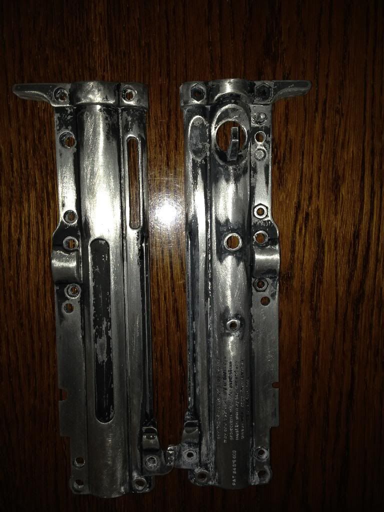

Originally Posted by first out View Post
If you have the time then just sand it off, if you can get to it. If you don't have the time/patience to sand it off then re-strip it. A wood handled wire brush will help a lot for the inside corners.
this is the best I can do (pic after second strip, no wire brush). Do you think I should get a wire brush and do #3 or this is good enough. I tried sanding a little with 220 grit but nothing else is coming off.
weiked is offline   Reply With Quote

If you are using regular spray paint then just make is smooth as you want and paint over what is left. If I were powder coating it I would be removing all of it.
