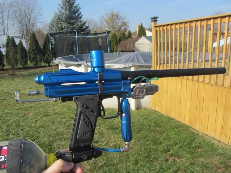

Zero B / Psycho Ballistics Chopping suggestions?
Settings are as follows:
TT Band 75%
TT TOL 12%
Release 4mS
Pull 1mS
Empty 2mS
SON 4.0mS
C OFF 28mS
C T/OUT 1.0s
C ON 65mS
C DELAY 6.0mS
Anyone have any suggestions? Doesnt matter how fast or slow I shoot it, eyes on/off and theres no blowback to speak of (2nd ball drops right into chamber)

Breech and bolt is loaded with paint
Itll shoot 4 to 5 balls fine, then soup. then another few. Barrel doesnt matter (Ive got both sizes eigen and normally dont use the smaller on a cocker), paint doesnt matter. I honestly think the bolt is closing too quick. Hopper (no matter what I use) is clean so its not blowing back. Detent FEELS fine and theres no sharps in the breech. Cocks fine on classic etc. This is why Im confused!

bolt and breech, then of course barrel
Mechanics are fine, What Im concerned about is are the settings good, or is something strange?

Chopping in a Cocker is caused by a bolt closing to soon and slicing the ball in half. This will cause paint, she'll, and all kinds of nastiness to be left in the feed neck and up into the hopper. This would most likely be caused by bad settings, a LPR set to low or going bad, or pump arm \ back block not set right.
If the paint is contained in the breach the ball is feeding correctly and breaking somewhere later in the process. Your settings would be correct and you need to look for another reason. Check for clean detents, no sharp protrusions on the face of the bolt or detents. Try a different kind of paint and a different barrel.
This is not definitive, just my experience from owning and working on my Cockers for many years. I have been known to be wrong more than once.

mmkay, after going over the gun front to back once again, all mechanics are fine, but I did enlarge the eye hole on the inside a bit. The design inside there is a lip, and the eye is right at the bottom of that. Runs fine now
