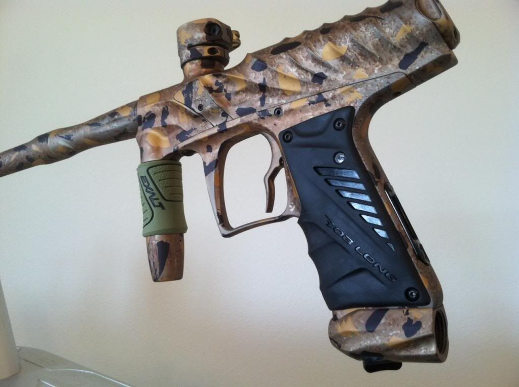

My Insight:
Breast Cancer Awareness Insight:

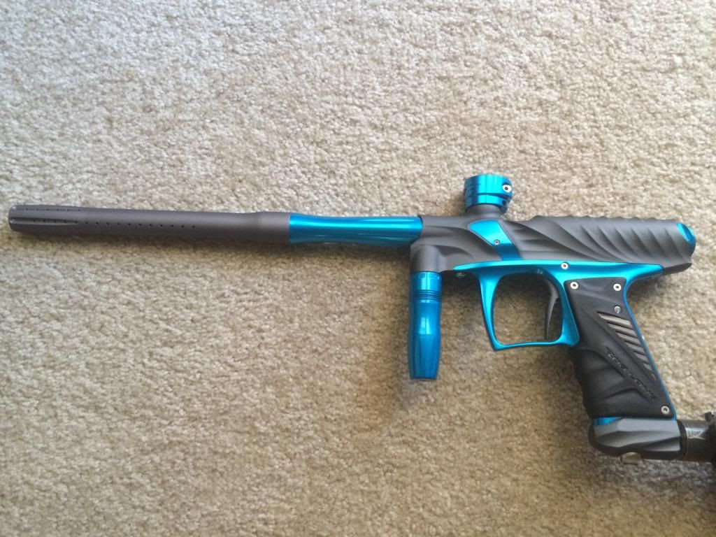

Just checked...still have the old o-rings. I will give BLAST a call tomorrow..figure out the o-rings as well as getting the board update. Thanks.
Anyhow, here is my new Insight.

I like that color scheme. What board flash do you have currently?

It's currently 5.1
