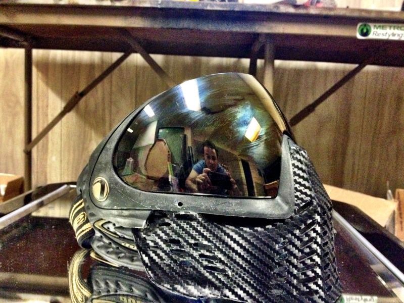

Finished Results:
I figured id make a progress thread as these are completed. Please do not blast my inbox with questions, post in the thread & ill do my best to answer them.
These are being made for myself as I always loved the i4 lens but hated how my jaw line was unprotected. This is a work in progress & my first conversion so bare with me.
Well I saw some Germans did some cool stuff with the i4's. Or I believe it was from a German web page then shown on pbnation..anywho I love the idea. I love the i4 but they dont fit my face as they seem to be meant for a child. With that being said the lens options and overall feel of the mask is awesome I just had no jaw protection so I figured id give it a shot.
More pics & progress as it becomes available.
Found this:
Inspired me to do this...work in progress!

Hard to tell in the pics but these are now drilled for the rivets. Waiting to finish the top then ill be using 3 rivets to secure the bottoms as well as some plastic welding around the nose to make sure its really strong.
Trimming these bottoms was a pita>but i like the results.

More updates, got my gold materials in today so ill be working on the top portion wrap & testing the rivets today.
More progress pics of fitment.
Note: The ear area will be trimmed more but want to get everything mounted before I circle back and decide on how much/what angle to trim at.
Im happy with how much additional coverage I have with these bottoms, I have new foam, and 2 lens on order. HD & Bronze Fire to finish it up.
This shows how much was trimmed & the 3 holes drilled for the rivets. Note that I should have left a little more at the nose area, this will work fine but id recommend leaving another 1/4" of material there. Ill end up using plastic welding to re-enforce the area.
This is a pic showing how much of the bottoms needed to be removed to slide into place under the i4's. I rounded the edges and removed quite a bit in the cheek area.
Fitment without rivets. The nose piece will need to have that small section where the original i4 logo sits due to the design, it will be raised up a tad more than in the pics but there will still be a small area there, there is no way around this but after the top is wrapped it wont be nearly as noticeable. Sometimes its function>form.

More work done today. The top is wrapped, now im debating on to trim out the dye logo or not. It has the gold/black dye logo so it would still match well. Also still have to install the rivets, do some more cuts & install the new foam.
Edit: Materials used
Arrow Rivets - Aluminum - Diam: 1/8th (3mm) long - Grip 1/2 (12mm)
Washers: #6s
Proshield Bottoms
Dye I4
Why did i go with gold? To match the gat of course!
