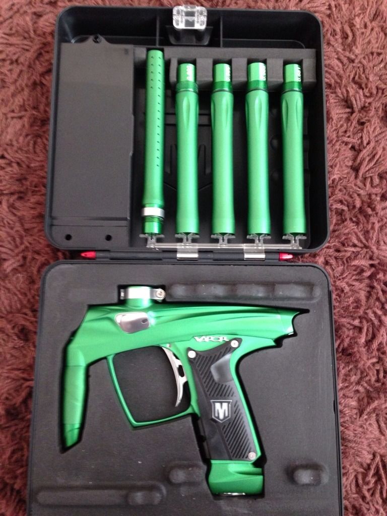

She looks so sweet just goto work out how to put a photo on
Thanks again guys 😀😃

She looks good just goto wait 2 weeks until I get some Air
Thanks guys
