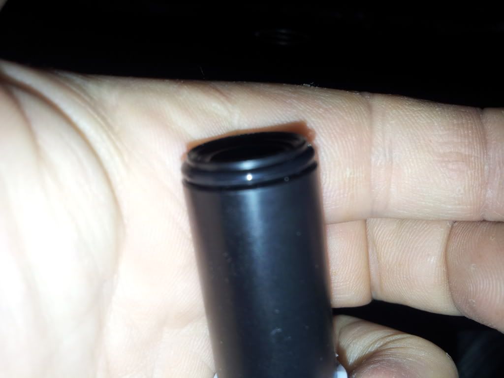

Is this the proper setup? I have the stock front bolt "condom" on the Lurker bolt then it is the delrin spacer and then o-ring. Some pics I have seen have have not used the stock bolt "condom" tip and used an o-ring instead. I am just wondering what the most proper install is.
With stock "condom" installed on tip
With o-ring installed on tip

Mfarmy you should try backing out your back cap to 1.5 turns out and see if the gun cycles consistently with the long spring.

Question
Originally Posted by Teahouser View Post
hey guys,
shot the dual oring cushion system today, super smooth.
280-285fps
160psi
5.5 open dwell
5 closing dwell
back cap 1.25 turns out
no chops/barrel breaks all day, shooting g.i. 3 star.
I just received a new replacement Shockwave board from Kee for my Invert Mini and I was wondering if all the settings stay stock besides the ones mentioned? Also, there is only 1 dwell setting that I see but I noticed that you have open and close dwell. Please help me out and I thank anyone for their time!
My setup is pictured above with the stock spring and bolt nipple cover
Vdubs is offline   Reply With Quote

Oh I saw the .8-1 and wasn't sure! As long as it works now!

Haven't been here in a while. That bolt "condom" or "nipple" you refer to is the bolt face. It should be on the Lurker Bolt when installed. Check step 4 in the manual:
http://www.lurkerpb.com/manuals/minimanual.pdf

I have used the stock bolt face. I was more concerned about the o-ring setup and the small white delrin spacer on the bolt. I tried to do it like pictured and I just had bolt sticks and chops.
