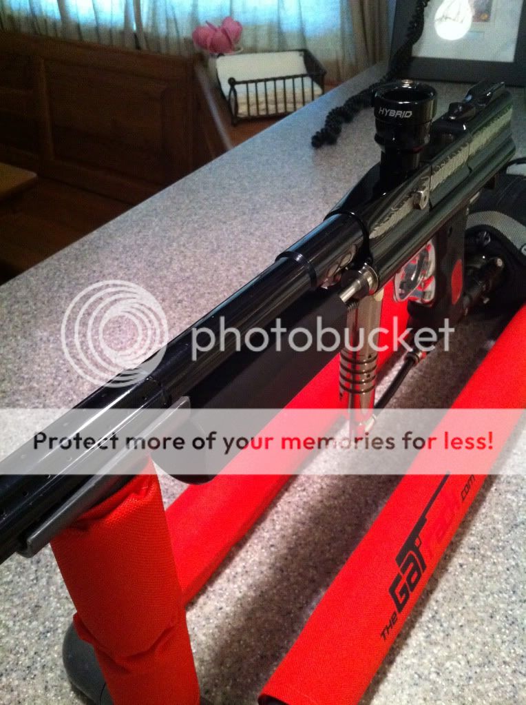

Originally Posted by Shocker_Monkey View Post
Looks awesome. Although I can't say that I've ever actually seen a pump angel. Curious how it would fire since the hammer opens the valve.
the bolt is independent from the hammer now
thats the 2nd slot in the breech and body
so if you pull the trigger it will cycle the air
super_stanchy is offline   Reply With Quote
Hah
I suppose actually LOOKING at the pictures would have helped.
I get it now. Very cool stuff.

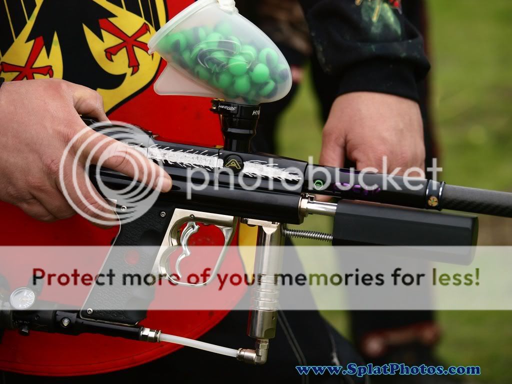

Where you been hiding dog?
Freak Bored my Jacko also.
It fires with the bolt forward in the closed position. I run a dwell of 28ms because I run a DM4 chip in a Lucky board on mine. With such a high Dwell it allows me to run my pressure at half of a normal LCD. My guide on the valve side, I made it hollow so to act as a volumizer. It it crazy consitent. + or - 2fps with decent paint.
COBRA G7,Angel 1,Master tech Angel Force Fly,Angel Gat,Custom Angel Led ,2000 LCD Angel Pump,2k1 Dark Angel,04 Angel Speed,C&C Angel IR3,Ice Fade G7 Fly,DM4,Eblade,Grey Ghost,PGP,2006 Grey Ghost,BLong Cocker,Angel G7,Cobra Mamba FLY,2K1 Angel Fly,Rasta G7 Fly,Dark 2K3 Angel,Euro Angel,2k2 Apollo Angel,2k1 Cobra signature series,Rev-i,Angel IR3 Fly,Disco Dust Dark IR3,05 Speed,2K Blazer,Rasta A4 Fly

Cool. I took an Angel hiatus for a couple years. :-( Poor decision on my part.
I can honestly say I never would have thought of a Pump angel.
With the pump rod moving the bolt, is that not where the LPR is? Its been a long time since I've taken an LCD apart.

the pump rod is in the battery tube. The pump guide is on the LPR side...

pump handle is finished
pump arm is freshly polished (took a few thou off on the badder, so it should slide more freely now)
hope my ANS package is waitin at home... fresh orings, screws and bolt!
gonna grind the breech down for feedneck clearance too

more pics from tonight!
Pump Kit is finished.
Guide Arm is finished.
Pump Arm is finished.
Pump Hammer is finished.
Pump Arm Bushing, needs to be faced and pretty
Body/Breech is ground/polished for feedneck clearance.
Body is milled for semi visible breech hinges.
Just gotta wait on the ANS order to put it together and test!
