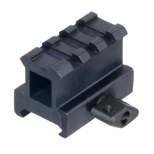

Ok, Went and looked at the Salvo for adding the Auto Rangefinder.
Elevating the rear peep sight should not be too much trouble. Your peep will come off that Picantany rail. Add a Riser or two.... and put the peep sight on top.
Ten bucks taint too bad.
Link: http://www.amazon.com/UTG-Profile-Ri.../dp/B003TWZG4G
Searched" Picantinay Rail "UTG High Profile Riser Mount with 3 slots"
Lots of stuff to look at and spend money on.
http://www.amazon.com/s/ref=sr_pg_2?...qid=1359605035
Dont know if this would be high enough but with another riser underneath it, might work. I would worry a bit about the down angle of the handle in the sight picture. It also might block you view of the front post requiring it to be mounted higher. Tippman makes a handle for their products. I would find a store and try it ON for size.
Ideally, you want that smallest bead hovering just above the tip of the barrel through you peep sight. That front rail will block that view. If you can remove that rail, you will have to have that rear sight, that much higher IF you are going to mount the front post on the front of the picatinny rail.
