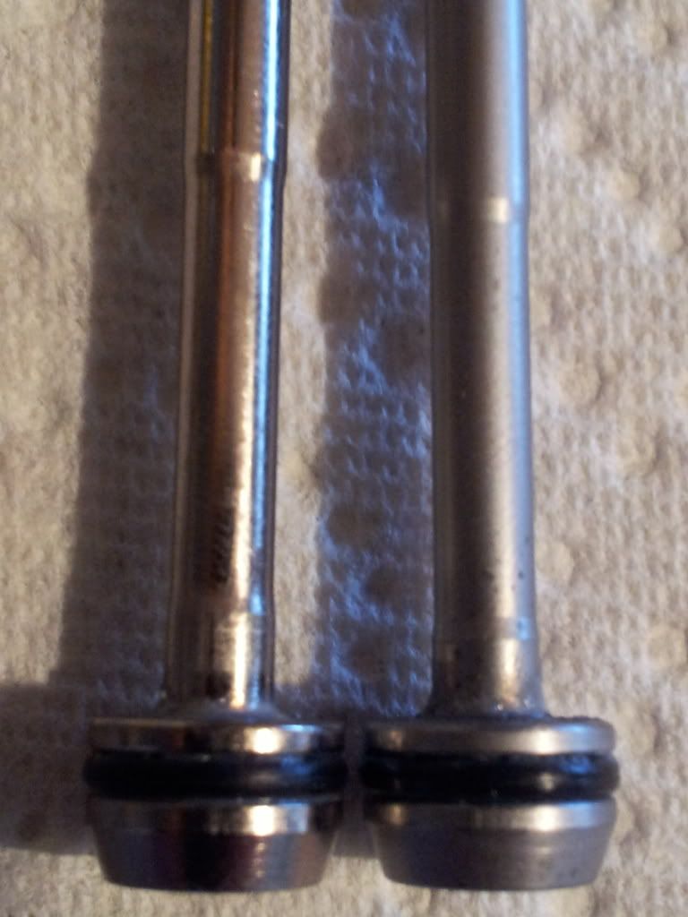

here's what I found:
i chronoed the ripper vic that I just got in and it was shooting 300 +-5, once even hit 315. Checked pressure and it was hpr 205, lpr 82 ish. So I put same pressure tester in the V1 and set pressures to match what ripper vic showed. Installed ripper vic (supercharged) engine in v1 and bam....same velocity...so that tells me its an engine problem for sure.
So I installed the ram shaft from the supercharged engine into the unsupercharged v1 engine, couldnt get it to chrono the same with the same presures but i reset pressures and now can get 285 +- 5 hpr 190, lpr 80, dwell @ 8. Also, since the supercharged ram shaft and stock ram shaft are different where the bolt attaches I also had to swap the bolt. Re-installed stock ram shaft and bolt back into stock engine, same pressures and 220 fps was it...
So I look closer at the ram shafts and noticed the stock ram shaft appears it was or is polished compared to the one out of the supercharged engine. Also the "champhers" near the back/bottom of the shafts are different...on the supercharged engine the champhers are lower on the shaft, meaning that as the ram moves forward the air will escape later with the supercharged engine then it will with the stock engine..???... not 100% sure what the purpose of the "champher" is but I believe it allows the air to flow up through the inside of the blast guide and ultimately to the ball....?? So it seems like its a way of "timing" if you will when the hpr air will flow to the ball in relation to how far forward or aft the ram shaft has moved by the lpr air. The supercharged ram shaft is slightly longer but with the bolt tips installed total over all length is the same. so it looks like with the supercharged ram shaft the air wont flow until the bolt has moved the ball farther forward in the breach, which I guess would allow for better efficiency....?? just guessing here..
I also measured shaft diameter using my dial calipers and they were both identical inside the champher as well above the champher. So looks like I need a new "supercharged ram shaft and bolt" not sure if it is the polished surface or the fact that the champher is different that is causing the velocity difference or the fact that the supercharged ram shaft and bolt is slightly lighter then the stock one... gonna relay this info to BLAST Monday and see what they say...
polished is stock, dull is supercharged
StyngRay2 is offline   Reply With Quote

So I spoke with Blast and they couldnt answer as to why the 2 champhered areas are different other then it may just be a machining defect. The shiny ram shaft is actually nickel plated and they stopped making them like that because the plating was chipping. So anyways....I ordered new "dull" ram shaft and bolt hopefully will be here Saturday.

installed the new ram shaft and works fine now, hits 280+, so it's now superhcarged (blast guide, ram shaft, bolt) other then having the white donut and the hole on top.
