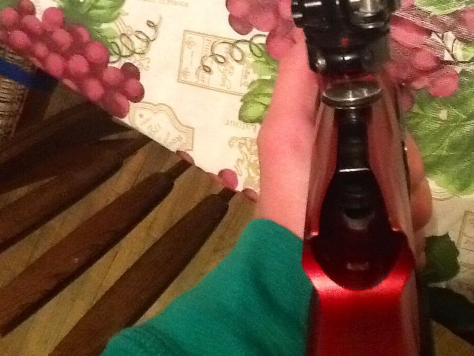

Here are some pictures of a Cure1 and Cure3+ in the forward firing position in my 06 Dark, notice how the Cure1 covers almost all of the rammer slot versus the C3+.
Cure1
Cure3+
