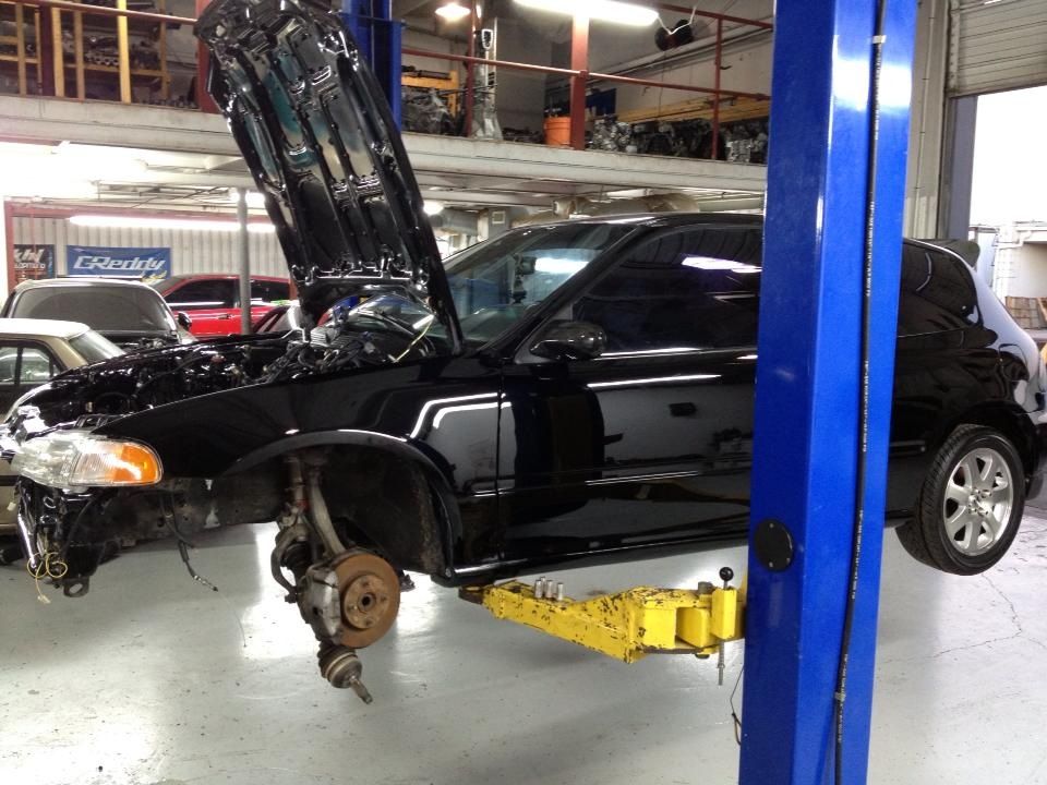

300+whp k24 to race in all motor sport at IFO. Alex isnt racing his red car at ifos anymore so he is building that to take to races with me racing in all motor pro

The car itself looks so nice

Paint job is pretty new
