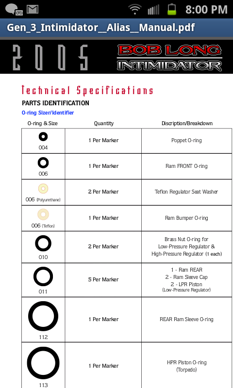

Yes, those Teflon reg seats. This brings up another question, will -006 teflon o-rings work as a replacement for those spacers/washers? Is Blast the only place to get those OEM spacers/washers if o-rings don't work?
I ask because I thought I saw on PBK's site -here- a pic that looks like just a -006 Teflon o-ring and not the yellowish-brown semi-transparent OEM part. I just want to get some feedback from those who may have had to replace the reg seat in the hpr or lpr.

.....thought i said that.....^^^^ its a 006 washer not an oring....and its not teflon its polyurethane.....

Yes you did. BUT, I also read the manual. Take a look for yourself. It says -006 Teflon. Anyway, now I know.
i know, i noticed that many years ago as well. it says teflon...but it also says polyurethane....it is polyurethane. not sure why they out the teflon part in there, must be a misprint.
[IMG]http://i292.photobucket.com/albums/mm15/StyngRay/SC20130213-200050_zpsc6bb2272.png[IMG]
Got me, just going by the 2k2 manual. Anyway, moral of the story that comes out of all of this is that, despite what the 2k2 manual says, don't use -006 Teflon o-rings for the LPR and HPR valve pins. They won't work.

The 2K2 manual is a little off and has mistakes. It also tells you to adjust your velocity by raising your LPR. My recommendation is to call BLAST. They'll get you squared away.
