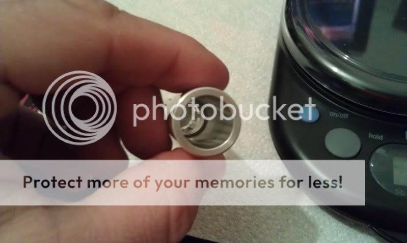

If you spring mod the 2012 bolt, you will change the ID of the rear of the bolt causing it to be non functional.
The sprung 2012 bolts are the same as the ones in the 2013 Demons
2012 Bolt
2013 Bolt
2012 Bolt
2013 Bolt

I can see the outside of your bolt is nice and buttery smooth at the back. Mine had a bunch of scratches and even when i buff the bolt I cant get rid of the deep ones. ill try and get some pictures
