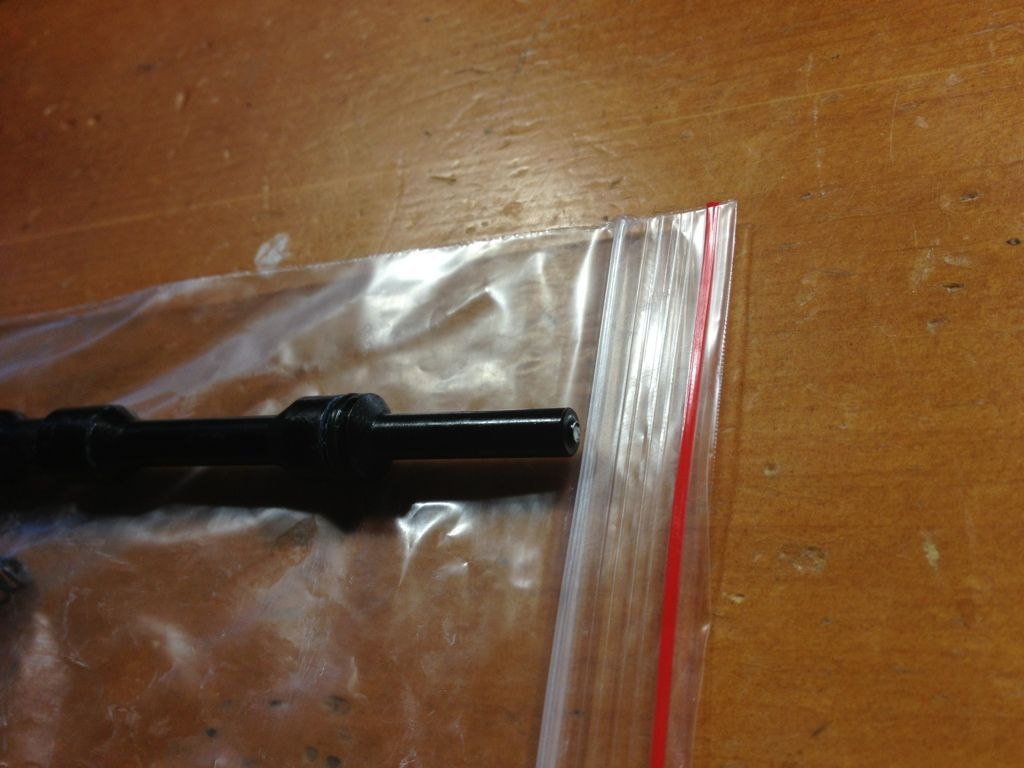

Pics?

Originally Posted by Goshawk View Post
Pics?

There is the answer. For some reason that part of the poppet has snapped off and is probably now jammed in the back of the bolt. This will stop the new poppet from going all the way up the inside of the bolt insert. As soon as you gas it up, the plunger in the back of the new poppet will extend and push the poppet and the bolt forward into the breech.
If you can send nick.t@planeteclipse.com an email he will arrange to get a new bolt out to you.

Thanks Jack, that makes sense. I never thought to look into the bolt insert where the poppet enters. I'll check later today and update this thread just as FYI to others. I will go ahead and email Nicky about a new bolt.

My friend's factory poppet also snapped off same as picture above during a woodsball tourney, told him to go to our local dealer to sort it out n get the springless... what caused it to snap? Batch of bad materials?

We have seen a couple of bolt inserts where the pocket in the back that the #004 o-ring slides into is fractionally too shallow. This means the end of the poppet is coming into contact with the bottom of the pocket which is stressing the part which can lead to it breaking.
It is also important to make sure that the joiner piece of the firing assembly is screwed in tight to the back cap. If it isn't tight, the poppet sits further forward than it should and this can make the situation worse.
Jack
Thanks Jack, that makes complete sense

Hi my name is jak, I think to have a similar problem with my Planet Eclipse Etha, because last week-and the bolt is stuck forward, compressing the spring. when I pressed the trigger I heard a different sound than usual.
the bolt is released only when I removed the pressure.
The same problem has happened to the marker of one of my team-mate, we bought the markers together and we shot about the same number of paintballs, we did 5 months of training and a small tournament.
Someone tell me what could have happened?

I have the same problem as above. Last week I broke the tip off my 3rd poppet this year. Gerry was nice enough to send me a new poppet and bolt the second time. I also had a problem with low velocity. Gerry sent me a new solenoid and that problem went away. I think I am out of courtesy parts. I have watched every video I can find for maintenance and disassembly to make sure I am not doing anything wrong. Although it is pretty simple so not too much to mess up. I love the gun when it works but this has been very disappointing.
