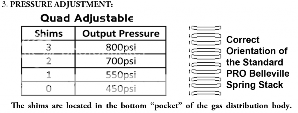

This should help, straight from Ninja's Website

I know what he means. My older ninja tank only has the two red shims not what u posted. Go to this site. http://www.ninjapaintball.com/docume...s%20Manual.pdf
I took out the 2 red shims that would bring it to 500 psi. and added a silver one to bring it up a little

prolly. do u have a reg tester. 500 should work fine. if u remove one the psi should be about 650. that might be better but im not a Vanguard tech. in fact i dont even have mine yet. (will on friday) LOL I was actually going through this same situation. if u live by any shops u can probably get a rebuild kit for under 10 bucks. that will have the silver ones. if u wanna mess with it. but 500 like i said should work. i dont think u will notice a difference in 50 psi. plus i heard people running on lower. just 550 is what is recomended
Nice post.
I run mine with no shims... its output is about 455-450..
