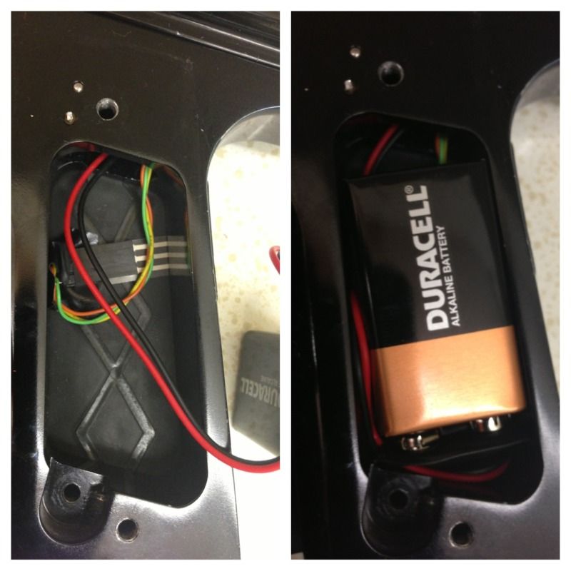

I've been in the process of modding my LED, and the first 'major' mod was the Scenario Dreams, Universial T-Board. It's nice to have all the current firing modes, as well as having converted the Angel to 9volt.
Speaking of 9volts, not all 9volts are made equal. Cheaper knock-off 9volts can be a bit bigger than your Duracell or Energizer 9volt. The space inside the LED is limited. Very limited. So limited, that the size of your 9volt will matter. Although, you could of course shave some metal from inside the grip frame if needed to be, but I'm pretty limited on the tools that I have on hand.
Here's a picture of what she looks like so far... Pictures added of inside grip frame. Doesn't show much..
Let me know what you guys think.

Looking good. Unfortunately the MT's never did the eye mod on the LEDs, and on a classic gun I lean more towards leaving them un-touched these days myself. With the Universal T board in it, you've always got the option available though, which is nice.

If you can install the board yourself, you'll end up saving yourself a few bucks. If you plan on having someone install the T-Board, you might want to consider holding on to your LED for some time, due to the money you're investing into your project.

ill be doing it my self for sure. but i plan on keeping it forever honestly. itll be a wall hanger if i loose my legs and cant play any more. could you post up some pics inside the grip frame maybe ??

Grip pictures added to first post.

thanks for putting up the pics clean work
